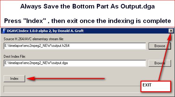

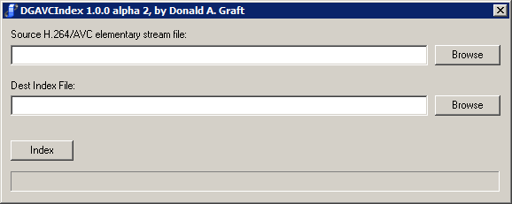

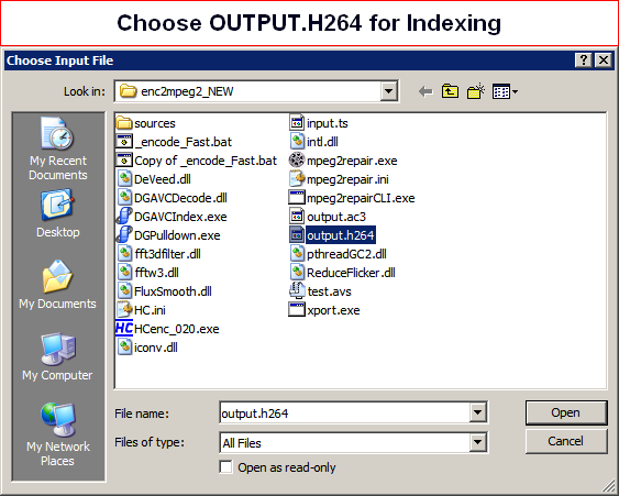

3) Creating the Script and the Index File for the h264/AVC file
This is where the DGAVCIndex popup happens. Follow instructions from above pics. You always want to choose "OUTPUT.H264" and the program will always create "OUTPUT.DGA" once you run the indexing.
