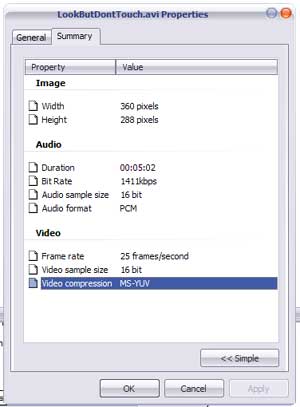

    Hi there, and thanks for the advice. I follwed a VHS > DVD capture guide on the web using VirtualDub because Nero was being a pain. It seemed to make sence and was advocating deinterlacing. I also have the problem of wavy lines at the bottom of the capture. Here's a screen grab of the raw file settings (which I still have). I take it that the bitrate is too low for DVD?
