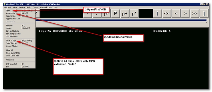

I'm going to recommend the ol' trusty Mpg2Cut2 for conversion from VOBs to MPG. It also seems to be smart enough to recognize and fix errors with the audio being on odd subchannels. (No dissing to you, Chrissyboy. I'm a big fan of your apps and expertise.)
Mpg2cut2 is reminiscent of VirtualDub in many ways. If you've done direct stream copy cutting with VirtualDub, Mpg2cut2 will be very familiar.
http://download.videohelp.com/download/mpg2cut2_6917_libmmd_mpalib.zip
