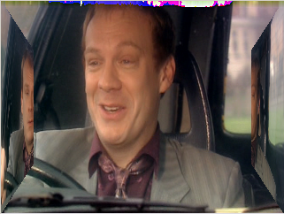

    Hi all, I'm using Premiere Pro 2, and have a fairly severe problem. Having ripped the content out of a DVD, and made sure the resulting video was playable, I imported it into Premiere, and made a short clip to test it out. When I exported the movie to huffyuv, however, the resulting movie had strange noise in it. Usually random lines of color at the top of the video for one frame, occuring randomly every 5 seconds or so.
    This random noise seemed to happen in a different fashion no matter what input / output format I chose for the AVIs. Setting the output to lagrith resulted in more solid color bands, and setting it to Xvid caused... a condition I could only describe as the video "having no keyframes." You could still see the video, but everything was grey and embossed looking. The only time I got a clean export was when I exported the video with no compression at all, which simply won't do.
    This seemed to happen regardless of the settings I used, and regardless of the size / codec used to encode the original clip. Attatched is an example of the problem I'm seeing.

    Unfortunately, there's no way to get around this. It's a hit and miss with your export.
    If anything, I have found that "Recompress" when you export seams to help.
    But for Huffy and Premiere, your export might always be corrupted (I believe it's a memory issue, but I can't be sure).
    Export to uncompressed AVI, then, using VirutalDub (or any other tool of your choise) compress back to Huffy for your final stored master.

  8. Well you can always export it to an uncompressed AVI from Premiere, then re-encode that to Huffy with VirtualDub.

    Indeed, I ended up using debugmode to do just that.
