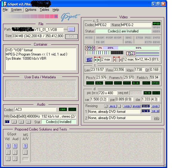

    Can you tell me how to get the Info off of the VIDEO_TS FIle...
    I Put the DVD-R in my Drive and I have GSpot open...
    I found the Video_TS File I tried to load all the Video TS File but to no Avail...
    Can you guide me from here...I opened GSpot Now what??
    Also How do I take a Screenshot and post it here?
    Ok I looked it up...I didn't know how to select all the VIDEO_TS Folder so I Just opened one of the VOBS....
    I hope this works.

    Does it help? I tried to open ALL 55 Files inside the VIDEO_TS Folder with GSpot...and I notice it says 55 in the USER DATA / METADATA BOX...
    It says...55 Files queued...Does that mean it is opening them or what?? Can you Check FULL VIDEO_TS Files with GSPOT??

    One is enough. They have been able to fit some many on by using a very low bitrate. Much lower than I would use for half-D1 resolution, but they are using full-D1. I cannot imagine that the quality is particularly good, but if you are happy with it, then you can use the same sort of numbers for your encode.
    But none of the programs you have listed will get you anything but low quality at these bitrates. To have any chance of it not looking like cold dog vomit, you will have to get your hands dirty and encode each episode manually, using multiple passes from a good encoder (HCEnc is building quite the reputation for low bitrate encoding), the author it all together at the end.
