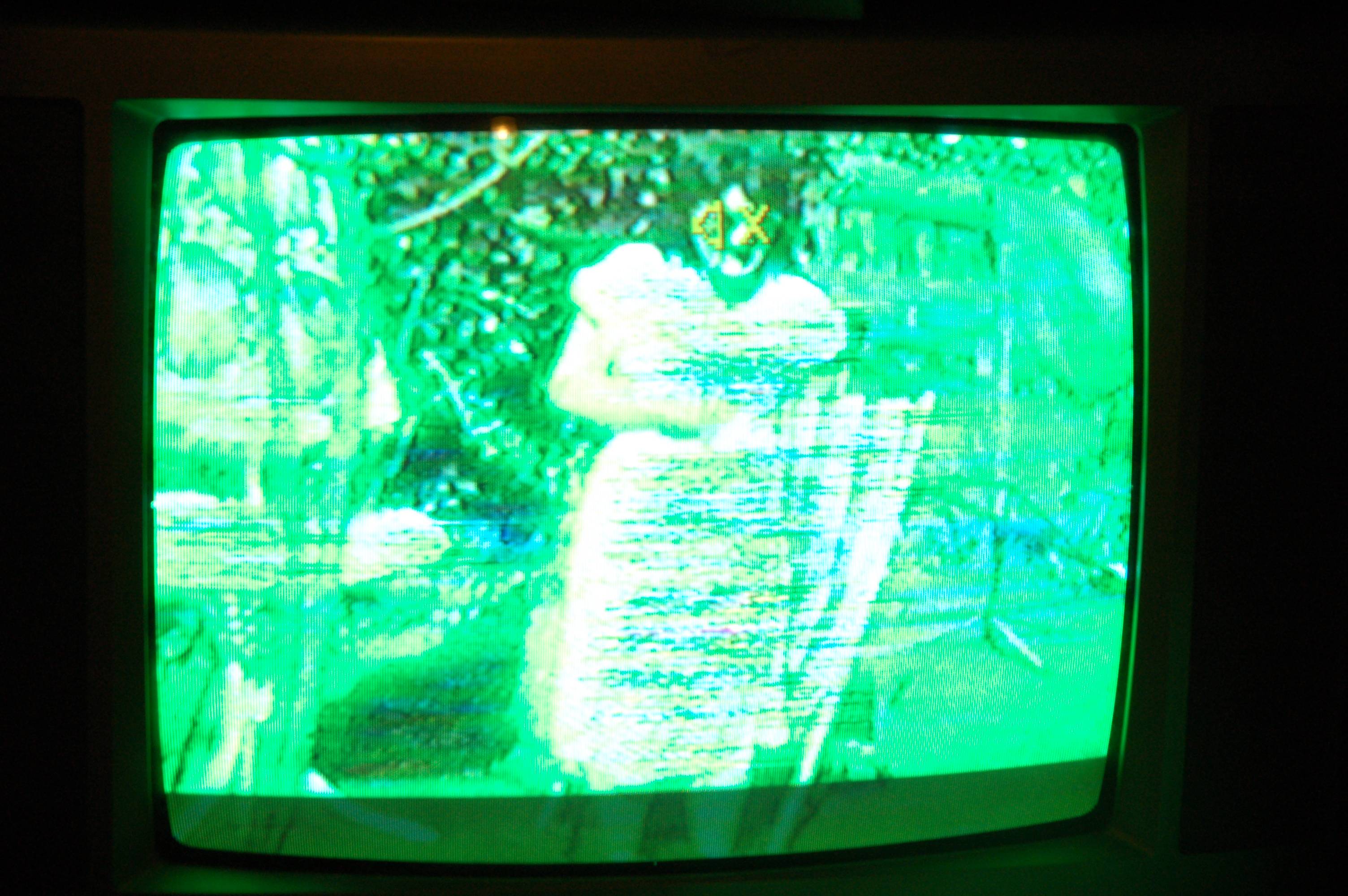

I've got a 20 year old vhs that's the only surviving footage of both my childhood and several relations before they died, however i was really shocked and depressed by the state of the video the last time i played it. (i've taken a picture of the tv with my camera to give you a better idea of what i'm talking about)
It's virtually unplayable at the begining (which is the most treasured material) a particular problem is whenever there's white on the screen (e.g. if someone's wearing a white dress) then in that part of the screen it has what looks like static in it's place.
The other big problem is the colours which are really really green now.
It's also just a bit jerky and unstable.
I've tried transfering the video myself using a standalone dvd recorder but as i said the quality was really bad, so i'm just hoping there's something i can do to salvage the material and hopefully at least get rid of that white area static problem.
So my questions are, does anyone know the specific problem with the white areas i mentioned?

I'm purely guessing, but it looks like it was stored near a magnet.
Getting rid of that much green ? Might make sense to convert the whole portion of video into B&W during post-processing.

That would be my choice, I consider myself quite proficient in VHS transfers but from your picture and what you describe it doesn't appear to be something I would attempt to tackle myself. As mentioned above if you upload a short clip you'll get better and more in depth opinions. A TBC might fix the jumpy issue and some others but overall what you describe a TBC by itself it isn't going to do much if anything. A TBC corrects timing problems such as vertical jumpiness or horizontal skew. In other words it gives you a nice stable video..... so i'd probobly be looking to get a professional to do it, however there seems to be only a couple of people locally who advertise to transfer tapes and cine film and i'm not sure if they'd have specialist equipment.

Hardware, or specifically analog hardware. Once transferred to digital you have an absolute perfect copy of what the error or problem is.Minor filtering and adjustments can be made with software filters but they are no substitute for filtering before it gets converted to digital. Your jumpy parts for example cannot be fixed once they are transferred to digital, at least not without a tremendous amount of effort with poor results.Is the biggest improvement made in hardware or software?
BTW I would avoid playing the tape until you get some more advice or decide what you are going to do with it. In conclusion you need someone with analog hardware and the skills to use it. Having said all that I wouldn't expect miracles. -

Without an actual captured clip there is nothing to work with. A digital photograph of a TV screen is not the same as the real thing by any stretch of the imagination.
However to be honest, I believe your attempt is in fact far worse than the original. It shows signs of heavy posterisation, loss of detail, and the colours are simply awful.Read my blog here.
You definitely will have to used hardware instead of software. I suggest Elite Video BVP-4. The most likely cause especially with old or rental tapes is that some oxide came off of the tape and clogged the spinning video heads. The oxide on old tapes tends to flake off and rental tapes are subject to abuse in VCRs of questionable pedigree. They may be creased or crinkled. Sometimes more serious damage results but in most cases, a good cleaning of the video heads

From the result, the tape either has serve drop out, and/or it is damaged thus the tape is not going around the VCR head drum properly.
The red color maybe caused by the macrovision circuit if you are using a current model of VCR.
You may want to play back on the original VCR, or a pre-1990 VCR, and check the result.
