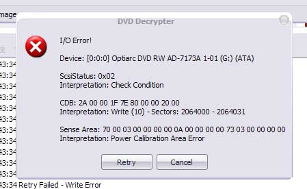

    Just to confirm, DVDdecrypter did not work. I get a power calibration error (see screen shot).

    SKiNFreak,
    I'm sorry to have to tell you this, but only Verbatim +R DL disks produce consistently trouble free dual layer burns, produced by a wide variety of systems and burners, and with a high degree of player compatibility.
    Your first post sounds like a problem between the media and the burner, and your second post (power calibration error in the layer break area, or shortly into the second layer) verifies that the burner and the media aren't getting along so well. Since you have some of the 8x Datawrite left, you could try burning at a slower speed. In all honesty, you're unlikely to get really good burns, but it may help in reducing your rate of coaster production until those disks are used up.
    The Verbatim disks may sound more expensive, on the surface, but once you factor in the waste produced when using anything else, and the player compatibility problems, they're actually the best deal available. As a bonus, you eliminate all the wear and tear on your nervous sytem caused by running a coaster factory.
