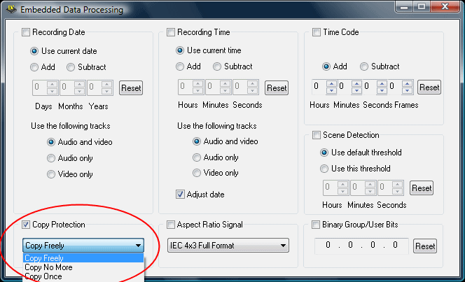

If you have some form of DV device (a camcorder or converter) you can get around the CGMS-A with our Enosoft DV Processor.
Specifically, feed the analog signal from your cable into a DV cam that has pass through or a converter box and capture to your PC. If the DV cam does what it is supposed to do, it will detect the CGMS-A signal and encode it into the DV data stream. Ordinarily, if you try to send the captured DV from the PC back to the DV cam, the DV cam will refuse to record it due to the encoded CGMS-A signal. Our software lets you change the CGMS-A flag.
I've confirmed this with protected DVDs, a Sony DSR-11 DV deck and a handful of Sony miniDV cams. Hooking a DVD player up via analog connections to the DV deck and trying to record a protected DVD results in the DV deck flashing "COPY INHIBIT" on the screen and disabling the recording function.
However, you can still capture to the computer via FireWire, toggle the CGMS-A flag and send it back. Now, the DV deck will record it quite merrily.
The software can change the flag while the capture is occurring - there's no processing required afterwards. If you happen to have two DV devices, you can do the whole thing on the fly without even having to capture to disk. That way, you could set up something like this in real-time:
Analog signal with CGMS-A ----> DV cam 1 ----> FireWire ----> PC running our software ----> FireWire ----> DV cam 2 ----> Analog signal without CGMS-A
