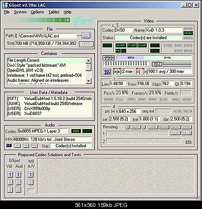

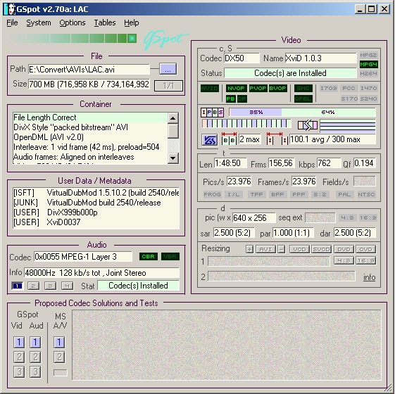

  9. Update:
    I managed to use gspot to confirm that the AVI's I'm using have the following info:
    Container:
    File Length Correct
    DivX Style "packed bitstream" AVI
    OpenDML (AVI v2.0)
    Interleave: 1 vid frame (42 ms), preload=504
    Audio frames: Aligned on interleaves
    Video: 593 MB (84.74%)
    Audio: 99.6 MB (14.23%)
    AVI Overhead: 7.17 MB (1.03%)
    User Data / Metadata:
    [ISFT] VirtualDubMod 1.5.10.2 (build 2540/release)
    [JUNK] VirtualDubMod build 2540/release
    [USER] DivX999b000p
    [USER] XviD0037
    Here's a SS of the Gspot app:
    Thanks again
