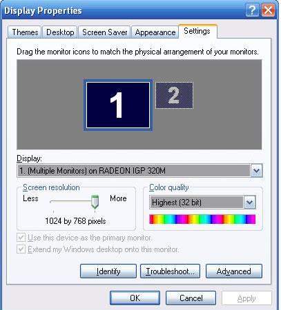

Try: 'Control Panel>Display>Settings'. You should see a page similar to this:
The second smaller monitor is my TV, which is not hooked up at present. Click on that one and you should see the settings there. You might try lowering the resolution to 640 X 480 True color @ 60hz and see if that works. If so, try some higher settings. Also make sure when you are trying all this that the TV is hooked up and set to play the video. I assume you have 'Extend my Windows desktop to this monitor' checked and you can see your desktop on the TV.
If no help, go to 'Control Panel>Display>Settings>Advanced>Troubleshoot'. Lower 'Hardware Acceleration' to about 1/3 and try it. If that helps, move it back to full and select your video control tab. They are named different, depending on your video card brand. From there it depends on your video card and you may have to consult your manual for your video card to see what type of overlay adjustments are available.
