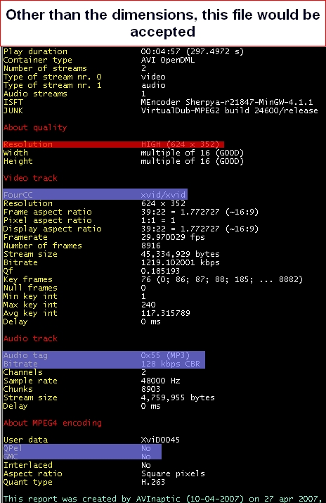

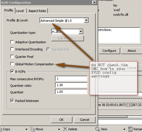

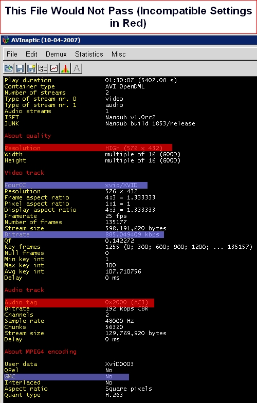

    I'm looking at their site at supported file formats (I don't have one, but I might be able to be of assistance).
    "The Creative ZEN can play XviD encoded files if these files are encoded as standard MPEG-4 Simple (SP) or Advanced Simple Profile without GMC"
    "Make sure the AVI file has the audio track in a format supported by Creative ZEN Vision. Files with AC3 (Dolby Digital) or DTS sound will not play correctly on the Creative ZEN Vision, because the player does not support AC3 (Dolby Digital) or DTS decoding.
    "Creative ZEN players support .MP3, WAV, and WMA audio format only"
