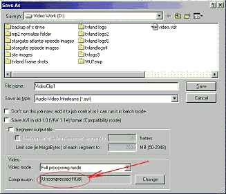

Now save to a file in uncompressed RGB format.

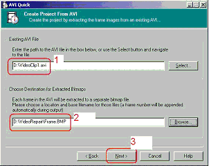

Select “Create a project from an existing AVI file” and then click NEXT.
Now click the ‘SELECT’ button and find the avi clip.
Next, select the BROWSE button and create a subfolder for the bmp files. Specify the filename root, for example “Frame”. AVIQuick will create a series of bmp files named Frame1.bmp, Frame2.bmp, Frame3.bmp, etc. Now click on NEXT and watch the frames get converted.

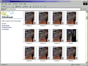

Close AVIQuick. Now, use Windows to view the bmp files in your subfolder. Select the VIEW > THUMBNAILS. This will allow you to identify which frames need some attention with your photo editor.

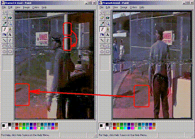

Take a look at the frames further ‘upstream’ and ‘downstream’ in the sequence. Due to motion of the camera and objects in view, these frames will not be identical. But perhaps the background hasn’t changed very much or perhaps you can find areas in common - damaged in one frame but not the other. In that case, open both frames in Microsoft Paint. Use the box tool to select the ‘good’ section of the ‘good’ frame and then copy it over to the damaged section of the frame you are restoring. Take care to align the borders so that it blends in as closely as possible.
When you have done what you can with sections from other frames, then you can try using sections within the same frame. For instance, the post of the guard shack in Frame14 of our example video.
Clearly, cut-and-paste methods will have their limits. At some point, you are going to have to fix the video frame pixel-by-pixel. It will get a bit tedious here. However, remember that perfection is not required. Each frame is one frame in a long sequence of frames and minor imperfections will not be noticed. Use your best judgment. By all means, spend some time practicing and developing your artistic skills. Learn what gives acceptable results (to you) with the amount of effort expended.
