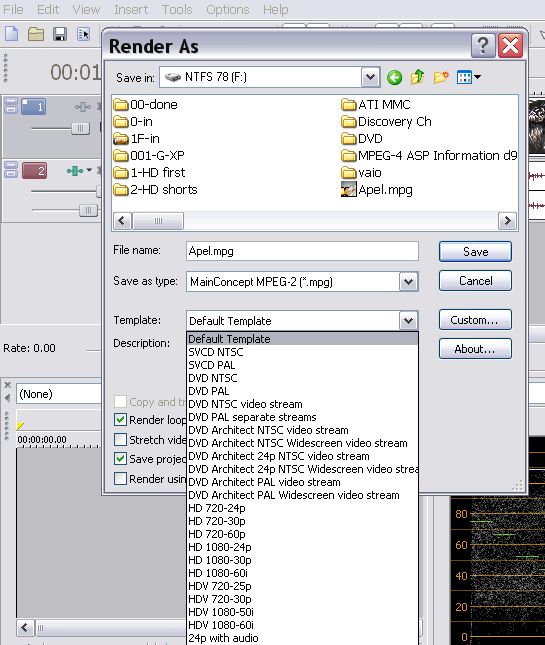

There is a difference between saving and rendering. Saving saves the project file with a .veg extension. This contains details about your source file locations, the edits and effects you have added etc. That's all it is.
To get video you have to go File -> Render As, set your output type and compression, and this will encode your video.Read my blog here.

as above - then render audio - same name, as ac3
but if i'm going to work with architect, the above mpg file will be recognizable by architect? and i did the previous slf fle rendered as DVD architect video stream
