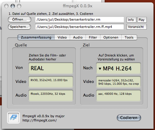

I found this thread and and I have further problems with .
1. I installed the "Binary Codec Package" ("Mac OS X x86 20060611") as said above in the folder /Library/Applicaton Support/ffmpegX/ with the foldername "reallib"
2. Now I can open RealMedia-files (.rm) in ffmpegX
3. I is also possible to encode this file in "AVI DivX" (mencoder) and works fine.
But if I now want to encode the RM-file in h.264 (mencoder), the progress-window shows after one second "finished", but the output isn't ready or readable. I didn't modify anything in ffmpegX - just select the new encoding-kind. And the video is an official dummy from the website mentioned above.
The report bring following message:
Where is the problem??Code:Encoding started on Sun Apr 8 15:09:09 CEST 2007 MEncoder dev-CVS-060307-04:23-4.0.1 (C) 2000-2006 MPlayer Team FIXME:Hardenabling SSE and SSE2 without detection Mac OSX static build for ffmpegX CPU: Intel (Family: 6, Stepping: 8) CPUflags: Type: 6 MMX: 1 MMX2: 1 3DNow: 0 3DNow2: 0 SSE: 1 SSE2: 1 Compiled for x86 CPU with extensions: MMX MMX2 SSE SSE2 Error: dlopen(/Library/Application Support/ffmpegX/reallib/drvc.so, 1): no suitable image found. Did find: /Library/Application Support/ffmpegX/reallib/drvc.so: unknown file type, first eight bytes: 0x7F 0x45 0x4C 0x46 0x01 0x01 0x01 0x00 success: format: 0 data: 0x0 - 0x289cd4 REAL file format detected. Stream description: Audio Stream Stream mimetype: audio/x-pn-realaudio Stream description: Video Stream Stream mimetype: video/x-pn-realvideo Stream mimetype: logical-fileinfo VIDEO: [RV30] 352x240 24bpp 15.000 fps 0.0 kbps ( 0.0 kbyte/s) [V] filefmt:11 fourcc:0x30335652 size:352x240 fps:15.00 ftime:=0.0667 Opening video filter: [expand osd=1] Expand: -1 x -1, -1 ; -1, osd: 1, aspect: 0.000000, round: 1 Error: dlopen(/Library/Application Support/ffmpegX/reallib/drv3.so.6.0, 1): image not found cale w=352 h=192] Opening video filter: [pp=0x33] Opening video filter: [harddup] ========================================================================== Opening video decoder: [realvid] RealVideo decoder Read the RealVideo section of the DOCS! VDecoder init failed :( Opening video decoder: [realvid] RealVideo decoder Read the RealVideo section of the DOCS! VDecoder init failed :( Opening video decoder: [realvid] RealVideo decoder Read the RealVideo section of the DOCS! VDecoder init failed :( Opening video decoder: [realvid] RealVideo decoder Selected video codec: [rv30mac] vfm: realvid (Mac OS X RealPlayer 9 RV30 decoder) ========================================================================== VDec: vo config request - 352 x 240 (preferred colorspace: Planar I420) [PP] Using external postprocessing filter, max q = 6. VDec: using Planar I420 as output csp (no 0) Movie-Aspect is 1.47:1 - prescaling to correct movie aspect.

Yes. I opend ffmpegX. Draged the "berserkertrailer.rm" at the left side of the "summary". Than I selected in the right side "h.264 mencoder" which shows the window as you can see at the picture some posts above. Now I pressed "coding", the progress-window opened and was reading one sec later and said "finished". At the desktop is a file "berserkertrailer.rm.ff.264" but with 0kb.
The report was again following:
Have you another result in your case? Again: If I just drag the .rm-Video on ffmpegX and press encode with the default encoding-prefs (AVI DivX), then it works...Code:Encoding started on Tue Apr 10 12:44:07 CEST 2007 MEncoder dev-CVS-060307-04:23-4.0.1 (C) 2000-2006 MPlayer Team Mac OSX static build for ffmpegX FIXME:Hardenabling SSE and SSE2 without detection (Family: 6, Stepping: 8) CPUflags: Type: 6 MMX: 1 MMX2: 1 3DNow: 0 3DNow2: 0 SSE: 1 SSE2: 1 Compiled for x86 CPU with extensions: MMX MMX2 SSE SSE2 success: format: 0 data: 0x0 - 0x289cd4 REAL file format detected. Stream description: Audio Stream Stream mimetype: audio/x-pn-realaudio Stream description: Video Stream Stream mimetype: video/x-pn-realvideo Stream mimetype: logical-fileinfo VIDEO: [RV30] 352x240 24bpp 15.000 fps 0.0 kbps ( 0.0 kbyte/s) [V] filefmt:11 fourcc:0x30335652 size:352x240 fps:15.00 ftime:=0.0667 Opening video filter: [expand osd=1] Expand: -1 x -1, -1 ; -1, osd: 1, aspect: 0.000000, round: 1 Opening video filter: [scale w=352 h=192] Opening video filter: [pp=0x33] Opening video filter: [harddup] ========================================================================== Error: dlopen(/Library/Application Support/ffmpegX/reallib/drvc.so, 1): no suitable image found. Did find: /Library/Application Support/ffmpegX/reallib/drvc.so: unknown file type, first eight bytes: 0x7F 0x45 0x4C 0x46 0x01 0x01 0x01 0x00 Opening video decoder: [realvid] RealVideo decoder Read the RealVideo section of the DOCS! VDecoder init failed :( Opening video decoder: [realvid] RealVideo decoder Read the RealVideo section of the DOCS! VDecoder init failed :( Opening video decoder: [realvid] RealVideo decoder Read the RealVideo section of the DOCS! VDecoder init failed :( Opening video decoder: [realvid] RealVideo decoder Selected video codec: [rv30mac] vfm: realvid (Mac OS X RealPlayer 9 RV30 decoder) Error: dlopen(/Library/Application Support/ffmpegX/reallib/drv3.so.6.0, 1): image not found ========================================== VDec: vo config request - 352 x 240 (preferred colorspace: Planar I420) [PP] Using external postprocessing filter, max q = 6. VDec: using Planar I420 as output csp (no 0) Movie-Aspect is 1.47:1 - prescaling to correct movie aspect.

What is invert mapping? What does it change? My result is now an 3,7MB-file, which isn't really finished. I think it is again just the video. But it doesn't seem so, that h.264-mp4 from an rm-file is codable with ffmpegX.
THX JuL!
ffmpegX always expects the tracks to be put in the "regular" way, that is the video first, then the audio. .rm and .wmv files often put them in the reverse order and the purpose of this option is to hint this particularity to ffmpegX.Originally Posted by JuL!
Don't ask me why ffmpegX doesn't automatically check both orders, I'm not the programmer.
Yes it's seems that, at this time, only .rm to divx .avi is possible through ffmpegX.But it doesn't seem so, that h.264-mp4 from an rm-file is codable with ffmpegX.
You'll have :
1/ either to use a two step encoding process -> first divx .avi, then h264 .mp4
2/ either to use a complex method -> separate video to h264 and audio to aac conversions (encode each track separately while disabling the second one), then use MPEGStreamclip to change the audio .mov to audio .mp4, and finally use mp4box in command line to mux .mp4 audio and .264 video in a new .mp4 file.Jean-Philippe Schuck
