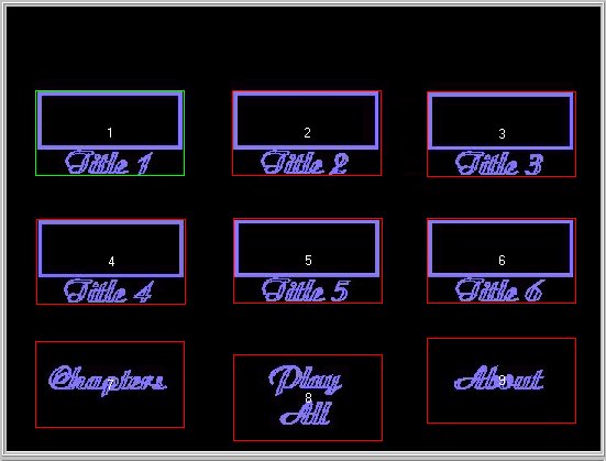

The authored project needed the following done in order to match the first picture snap of the projects completed content , further down .
Right click on menu1 , and select "set menu type" and set to "root menu" .
Right click on menu2 , and select "set menu type" and set to "chapter menu" .

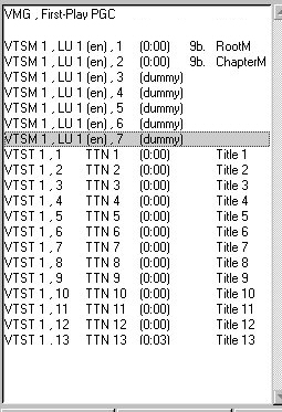

Now right click on menu2 , and select "new dummy pgc" ... your adding 5 dummy pgc's using this procedure repeatedly ... save dvd when done this far and the project will now appear as in picture 1 .
Ok , here is a snap of the project's layout so far in pgcedit .
Ok , and the menu's used as well .
Menu 1 .
And menu 2 .
Now for the nav command's used for the project ... to make it simple , all you need to do is copy the block's of text , and simply paste them where required , taking note of their headings above for pre or post ... you dont want to put them in the wrong place's .
You will need to input those used for the button's though .

INFO :
As you will have seen ... highlight command's for each button , must not be cross-referenced ... you can see a little of this in VTSM 1 , LU1 (en) , 7 , where gprm's using value's 7 to 9 have no reference and neither do value's 16 to 18 .
This is due to both the "chapter" , "play all" , and "about" being referenced as in
1: Chapter use's (7) menu1 and (16) menu2 , and each chapter button is "set" using each other's menu gprm to link to each others chapter button .
2: Play all's from both menu's use their gprm's which initially highlight's them , and both are routed via dummy pgc's 3 and 4 ... you will note that each title has nav's used to tell the difference between "go to next title" or "return to menu" .
3: The About feature use's the same feature's as per play all , yet dose not require nav redirection , it simply route's the initial nav command received back to the menu after the play back of title 13 .
Going back to menu 1 , you could route all gprm value's above 9 via using a single command such as
[20 D4 00 00 00 09 00 02] 1 if ( gprm(0) > 9 ) then { LinkPGCN PGC 2 }
This would re-direct all gprm value's above 9 to go to menu2 instead , using a single nav command .
