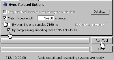

    Go to Tool's , Export audio to wav file .
    Resizing tab , select "match video length" , and "by compressing encoding rate to ?????mhz" .
    Hit "run tool" .
    You will be asked for name and place for it to go ... call it adjust.wav , and let it perform it's function .

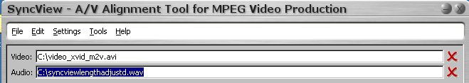

    Close that window when it's done the job .
    Under audio , you now double click it , and select the new audio file that was just written out .

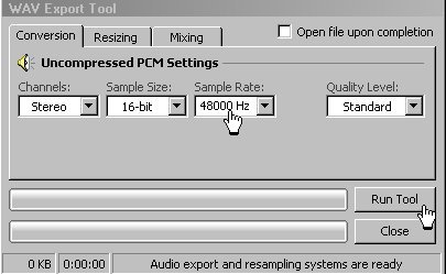

    Go back to Tool's , Export audio to wav file ... as adjust2.wav
    Now go to "conversion" tab , and set to 44.1khz , and repeat processing step .
    Here I have chosen 48khz , as the audio is being used for a dvd project .

    The first part is to match the video's length , which any tool can do simply by changing the frequency so the audio match's the video's length .
    What fmod dose , is keep it bit for bit during the reprocessing to the new frequency without affecting the new length ... it's acurate .
    You must use resize tab first ... check what it say's the frequency will be changed too , and note the fact you cannot set the frequency under the conversion tab till after the first process has been performed .
    By simply changing the frequency under the "conversion" tab , all your doing is affecting the length of the file and introducing distortion ... and the new file will not match the time length of the video it is being resynced too ... and thus , your forced to do it the correct way as explained in this guide .

    You describe a two-step process, but you can do BOTH parts (resizing and re-sampling) in one step.
    What you are doing is resampling @ 44.1 (to resize), and then resampling again @ 48 (to reformat).
    Running both steps in separate operations is a waste of time. It's got to be taking you at least 60% longer. Just set the NEW target sampling rate from the start, continue with the rest of your steps, but ignore the last part.

    Take no notice of what is being reported in the pciture as to the original audio's bitrate ... pay more attention to the difference in the length between the two stream's , being the video , and this audio file , and then you'll see why it has to be done this way .
    Take another look at the "resizing part" and what it reports the new frequency will be in order to make the audio the full length of the video clip and you will see why there is a need to do a 2 step process in the first place .

    Third, when you use re-sampling to resize, the new audio is NEVER really 44.1 or 48 anymore. The original audio data is re-encoded to xx.x Hz, but the WAV file header is exactly 44.1 or 48. That is how the stretching/shrinking is accomplished.
    SyncView uses the desired "playback" frequency (Conversion tab) when it calculates the amount of compression/expansion needed to produce a wave file of length L. Set the sampling rate to 44.1 and you will see that SyncView uses a certain adustment. Now set the sampling rate to 48 and you will see that SyncView uses a different adjustment.
    It doesn't matter what your target playback frequency is. SyncView will always stretch or shrink the new audio to the length that you want. If the length is correct but the audio is still not aligned, it means you are using the wrong technique to resize.
