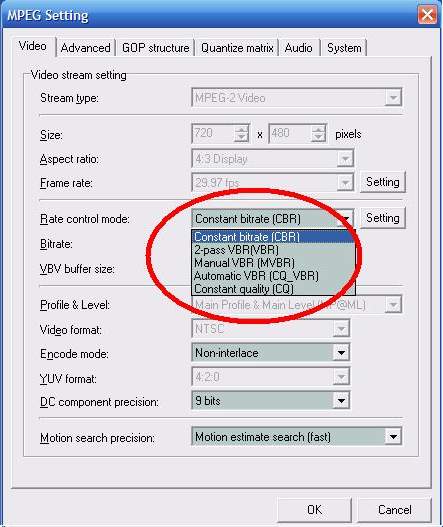

I usually use constant quality (aka constant quantizer, target quantizer) encoding.

Use constant quality encoding and you'll get exactly the right bitrate for the quality you specify.Originally Posted by Anakin
