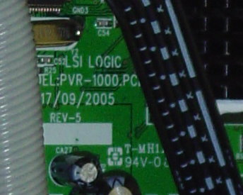

    The Polaroid is a re-badged DVR-3000 recorder:
    http://www.made-in-china.com/image/2f0j00uCntcBrSAaqyM/DVD-Recorder-DVR3000-.jpg
    The boards inside it are marked DVR-3000.

  17. I looked at the boards pretty carefully in the 2001G but found only the power supply board has DVR-3000 labelled on it. Other boards are labelled PVR-1000 including the one with the LSI processor.
    Also, the link below to the specs for the DVR-3000 show it is a non-hdd recorder. I do believe many of these recorders are made in the same factory and it would not be a big surprise to see parts from several models being cobbled together to create a new one.
    http://www.made-in-china.com/showroom/sinotek/product-detailRbCxcorSZJVy/China-DVD-Rec...-DVR3000-.html
    In terms of construction, it appeared to have some nice manufacturing touches, but was physically larger than I would have expected from a newer design. The Pioneer 531H is much smaller by comparison.
    Mine says PVR-3000 on the mainboard. The power board said DVR-3000.
  25. Originally Posted by Lordsmurf
    Here the numbers from three boards I looked at. Looks like Polaroid has made some changes, maybe not for the better.
