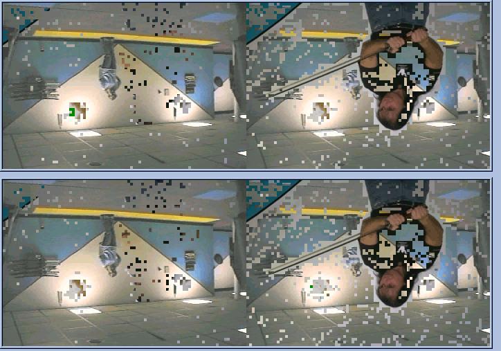

I have been trying to the "Stack Horizontal" in VitualDubMod 1.5.10.2 using the Stack script.
What I want to do is have a video on one side playing as on the other side a slide show video is playing.
Both videos are 352x240 VCD MPEG-1 that I converted (using VitualDubMod) to AVI using the Cinepak codec)
In the past. I had no problems, but, I have come up with two problems that I hope someone can help me with.
The first is that the resulting video is (even in preview mode) upside down and fliped.
This I can fix, but, the second problem is the one that I can't seem to fix.
The resulting video act like it was chromakey. The image from the slide show video superimposed on the first video. Plus there is a lot of pixilated "noise" and even parts that are transparent. Just like one would see on TV when the weatherman does not match the green background.
For a example I have enclosed a still from VitualDubMod to illustrate what a mean.
What can be the problem?
The original videos?
The conversion process?
The software?
Thanks for any help.

I was able to partially duplicate your problem using AviSource() and Cinepak. Using DirectShowSource() instead worked fine.
v1 = DirectShowSource("E:\cinepak1.avi")
v2 = DirectShowSource("E:\cinepak2.avi")
return StackHorizontal(v1, v2)
AviSource() and Cinepak just don't seem to get along. Using Lagarith or Xvid worked fine with AviSource(). -

Just about every implementation of Cinepak I've seen has used palettized color (<16bit). This seems like it could be a (bad) interaction between the palettes of the 2 images.
Nobody should be using Cinepak anymore...
Scott -
It even happens when opening a single cinepak file with AVISource(), without stacking. That is, just AviSource("cinepak.avi") returns a messed up picture.
