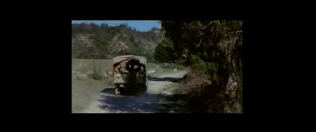

  6. Hi-
    Your picture shows it to be widescreen. Assuming the pic is at the correct AR, then you can just resize it to 544x288 and it should be OK. It seems to be standard 1.85:1 video. I'm assuming all that black was added later. If it's part of the pic, then 352x192 might work better. Anyway, if you know enough, (crop and) resize it in AviSynth before frameserving it into VDub. Or do the (cropping and) resizing in VDub itself before reencoding it to XviD.
    Edit: And if the pic isn't at the correct AR (it's hard to tell), and it's really supposed to be 4:3, then cropping and resizing for 352x208 (or maybe 480x288) would be better. Followed by a reencode to XviD. That would make it a 1.66:1 movie (or thereabouts).
    It's hard (for me anyway) to tell what you've done with that pic, as it's 640x268, and not at all the dimensions you quoted earlier. With only that pic to go on, it's hard to tell what you have and how it should be treated.

  15. Member Cornucopia's Avatar
    Audio is bad mainly 'cuz it's such a low samplerate. At that point you can't use the MPEG1layer3, you have to resort to MPEG2layer3 (which is what it did). If you're playing with a MP3 player that only supports MPEG1layer3, it'll give you garbage (too bad, should have been coded better). If you're playing with a MP3 player that supports MPEG2layer3, you'll get a half-way decent signal with alot of "birdies" in it (aka compression artifacts), but still quite listenable. To make this work, re-compress to MPEG1layer3, 16bit, 44.1kHz sample rate, mono, CBR, at ?? 192 or 224kbps. Then, just about any mp3 player in the world should be ok with it (won't improve the quality any though).
    VIDEO
    Stick it in Vdub, add a null transform filter and crop it down (X1=146, X2=150, Y1=42, Y2=40) to 344x186.
    Add a SmartResize filter and resize using Precise Bicubic to 640x346 (close enough). Pad with black for letterbox to 640x360 for use in 16:9 displays, or to 640x480 for use in 4:3 displays. This is all assuming your player doesn't support Anamorphic/Non-squarePixel AR.
    Give it a good enough bitrate this time: >800kbps at least (play with this to see what works for you). Reencode to Xvid, with similar parameters for quant, framerate (although, to be anal about it, it probably should be 29.97!), etc.

    Yer a genius Scott, the file converted as per yr guidance. Alls well. Thx a million once again. Cheers
