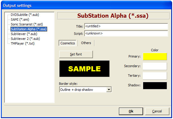

When you load the SRT subs into SUBTITLE WORKSHOP go to SETTINGS at the top and then under that heading look for the option called OUTPUT SETTINGS and click on it.
You should then see something like this:
Notice I selected "SubStation Alpha (*.ssa)" on the left hand side.
Now you can select the properties of the subs such as the color and font type etc.

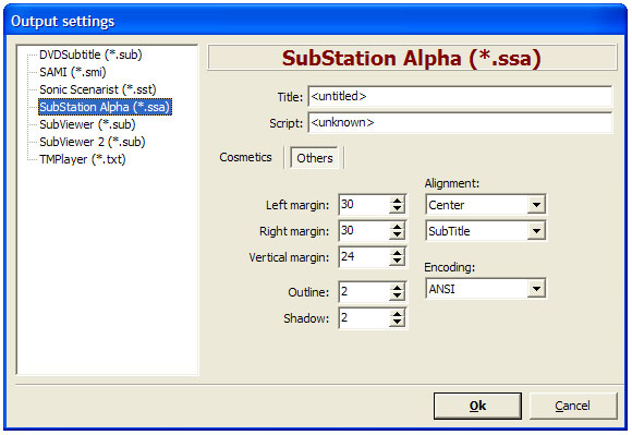

Now click on where it says OTHERS and you get the following:
See the option called VERTICAL MARGIN ... that controls how high or low the subtitles appear in the image.

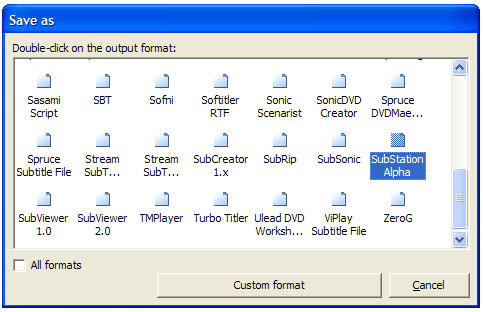

Now go to FILE at the top of the screen of SUBTITLE WORKSHOP and select SAVE AS and you will see the following:
Scroll until you find the "SubStation Alpha" option. Double click it. Now save your SSA subtitles.
