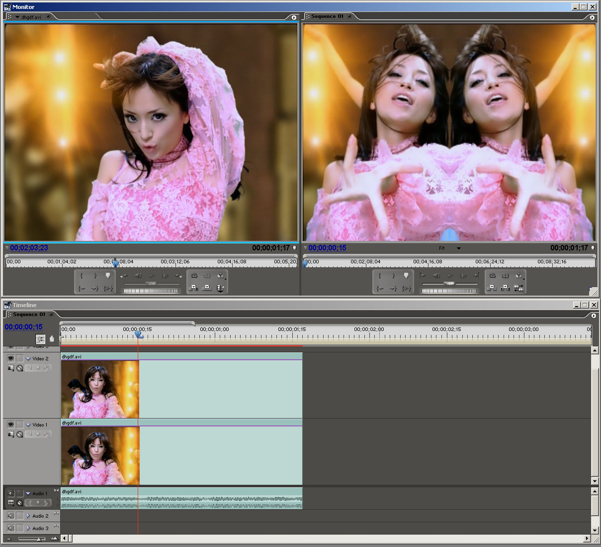

I don't know how vegas works, so I'll try to use a generic way to describe what you can do.
On video track 1, copy your footage, and put it above the original.
Like this:
VIDEO TRACK 2: Copy of Clip
VIDEO TRACK 1: Clip
On video track 1, apply Mirror effect.
Then, on video track 2, apply a linear wipe. This should cut the image and reveal video track 1.
If I understand you correctly, this is the effect you're trying to do?
