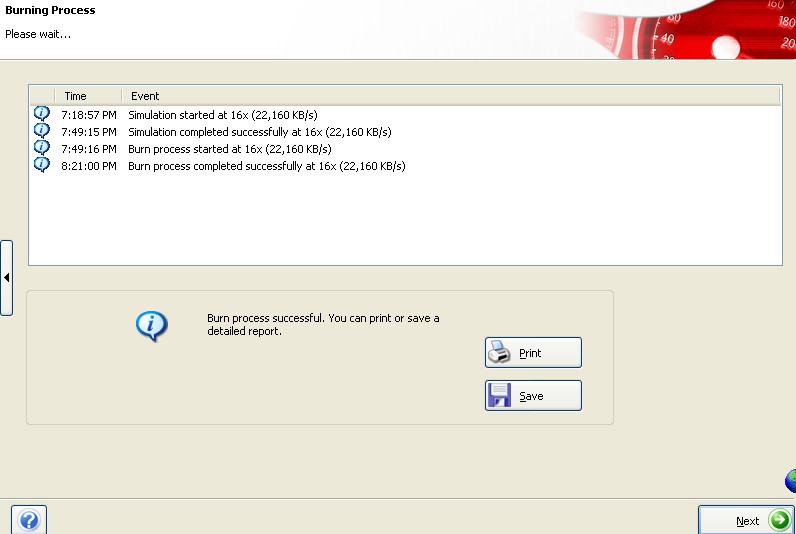

    I am running Nero Ultra Enhanced version 7.7.5.1. Until recently whenever I copied from an 4x/8x/16x dvd's the process would take 30 minutes tops from simulation to actual copying. Just last night for some reason both the simulation and copying process are taking 32 minutes each! I know that depending on the speed of the disc your copying from that the simulation could take up to 30 minutes but until now that didn't effect the speed of the burn process especially if the disc I'm copying to is 4x/8x/16x.
    For the life of me I can't figure what's causing this problem but it really irks me that now a relatively simple and quick process will now take me forever to achieve. (See attachment) Right now as I am writing this I am copying a dvd and as you can see it took from 7:18 until 8:21 just for one copy!

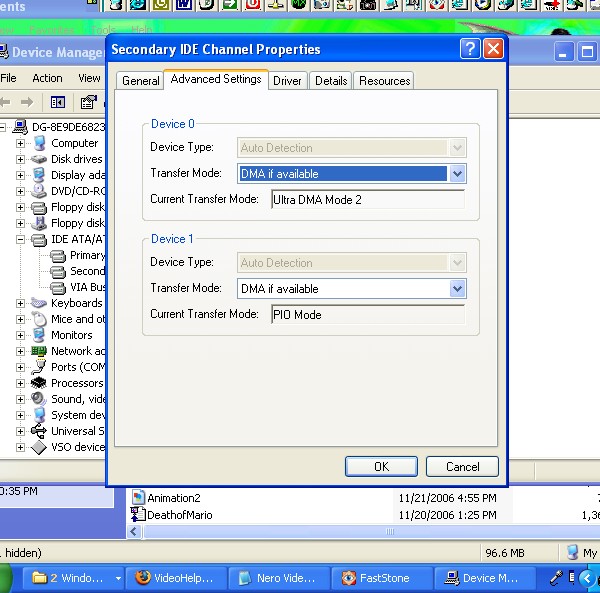

    You might check your DMA/PIO settings and see if the drive has reverted to PIO mode:
    To check DMA/PIO mode within Windows:
    Control Panel>System>Hardware>Device Manager>IDE ATA/ATAPI controllers.
    From there, right click on one of the channels and choose 'Properties>Advanced Settings'. All drives should be DMA mode. The 'Current Transfer Mode' for Hard drives is usually DMA 4-6 and DVD burners DMA 2-4, DVD ROMs usually DMA 2. If you see any in PIO mode, that can slow things down.
    Changing them back may be easy or complicated. First see if you can change them in that window. If not, I usually uninstall the channel the drive is on and let the OS reinstall it. This will usually take a reboot. This will not damage any files on the computer.
    But your problem may be the burner or Nero. Have you tried a different burning program like ImgBurn to see if it has the same results? If it isn't PIO mode or Nero, then it could be any number of different things. Among them the burner may be failing or at least needs cleaning.
    Nero should have generated a log file that often tells you what the burner and Nero are doing and what errors there may be. You can post that here and it may help. Your screenshot seems to say it's operating at 16X speed, so something is causing the slowdown.
    I guess I'm not clear either on why you are doing a simulation before the burn. Are you copying the DVD or is Nero re-encoding it?

    Hello redwudz:
    First let me thank you for your help.
    I checked and yes the 3520AW is in PIO mode. While I managed to change the transfer
    mode field back to DMA I was unable to change the Current Transfer Mode back to DMA
    mode.
    When you say uninstall the channel the drive is on do you mean that you disconnect
    the IDE cable from the motherboard???

  6. Mod Neophyte redwudz's Avatar
    USA
    If you right click on the offending channel in Device Manager, you will see the option to 'Uninstall'. Do that and reboot and usually it will reset to DMA. No unplugging needed. The reason it does that is a Windows 'feature'. With PIO, it will still be able to read the drive, albeit at a much lower speed. Unfortunately, there is no automatic way to restore it. If you uninstall the channel and reboot, Windows will restore it and reset it to DMA most times.
    The reason it happens is that if Windows sees 6 consecutive read failures from a drive, it automatically changes it to PIO mode, which is really slow. If your are having a lot of trouble reading a disc and you hear a lot of 'seeking' noise from your DVD drive, it will likely revert to PIO.
    If you can't reset it by uninstalling the channel, then you will need to do some registry changes. Uninstalling the channel is much safer.
    If uninstalling doesn't work, get back to us.
