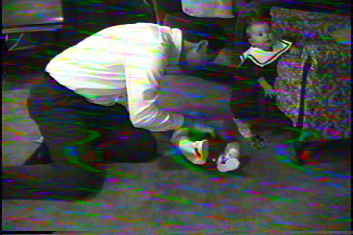

I have a Panasonic AG-1980 going from S-Video into a DV camcorder which feeds into my computer. I record with Pinnacle Studio. Is that what you wanted?
The scrolling lines look like some type of AC hum interference. If other tapes play fine on the same setup, then this interference is most likely embedded into the recording.
Can such a thing be fixed or should I just rip the color out? Will a TBC affect it? Thanks for the responses!

This is what video looks like when I have a PAL or NTSC tape set to the wrong signal output. It's ghastly.
Any advice on how to fix it? I suppose I could just pull the color off the video, but I'm curious as to whether or not some hardware could fix this type of error. It's the first real problem I've hit and I'd like to do my best on resolving it. Thanks for all of your help!
To me it looks like a field 1 field 2 issue.
Did you say TBC? Someone else posted a similar split field issue and was using a TBC.
Quick test. Bypass the TBC and post a frame.

here is a snap of the video without TBC. No difference that I can see. Any ideas?
Is this happening because my TBC is only a full-field TBC? Would a full frame TBC squeeze the colors into submission?

Something I'm really curious about is whether a TBC can correct such color "surfing" / "drifting". Didn't edDV say it was a "field 1 field 2" problem? Would that then and therefore be fixed by a full-frame TBC? My Panny has a full-field TBC, so it only covers field 1 or 2, but not both( I think ), so wouldn't that be a legitimate reason for me to suspect I need a TBC? I'm interested. -
Hello all. Was searching through the internet looking for a fix for the exact problem you are having...wavy, red and blue lines through picture. I have 9 of the AG-1980's, 3 of which have this problem. I've isolated the fault down to the Y/C pack in the 1980 itself. Appears that one of the video amp/filter ICs has failed. I'm working on buying a few ICs to see if it's a fix. Have you found anything since your last post. Thanks for any info. Great board here.
