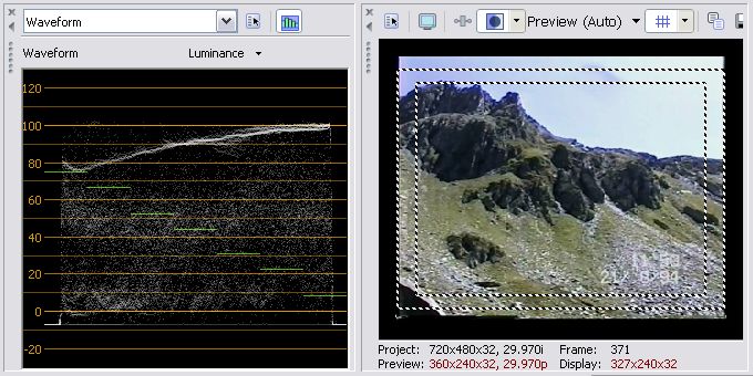

    No I'd try to copy the VHS to a dvd-r with a standalone DVD recorder. The picture is quite good but the colors seems too bright or washed at some places.
    Here is a sample:
    Is there any avisynth or virtualdub filters that can improve the picture quality without spending a lot of hours just to see that the final result is the same as the source ?
    Thanks.

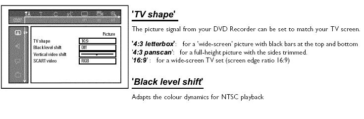

  5. What is the brand and model of recorder you are using?
  6. The recorder is a Philips DVDR70. All my other copies are perfect. When I play the VHS on the TV the result is the same as on the dvd.
    The main problem is the source.
    Is there any filters (avisynth or virtualdub) that can improve the quality ?
  7. If I understand you correctly, this tape when recorded to dvd is a bit bright and washed out. This may be due to IRE from the tape being off. The IRE level determines what the recorder will consider to be a black level. For example, VHS sources have IRE black = 7.5 but some recorders allow IRE = 0 for black. If you record with an IRE=7.5 source to a recorder set for IRE=0, the video will appear a bit bright and washed out because the source can only get down to an IRE of 7.5 which is not black to the recorder but a dark gray.
    It looks like the Philips recorder can accommodate either. Which way do you have it set?

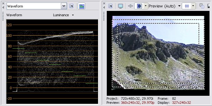

    That looks fairly typical for VHS camcorder although strangely cropped (wide blanking). Consumer camcorders record "bright" to make signal to noise and low light appear better than they are.
    This is a simple -5% luminance level correction. More could be done.
