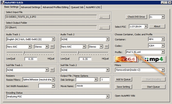

    AutoMKV seems to work pretty well. It certainly uses uses good apps to do the processing.
