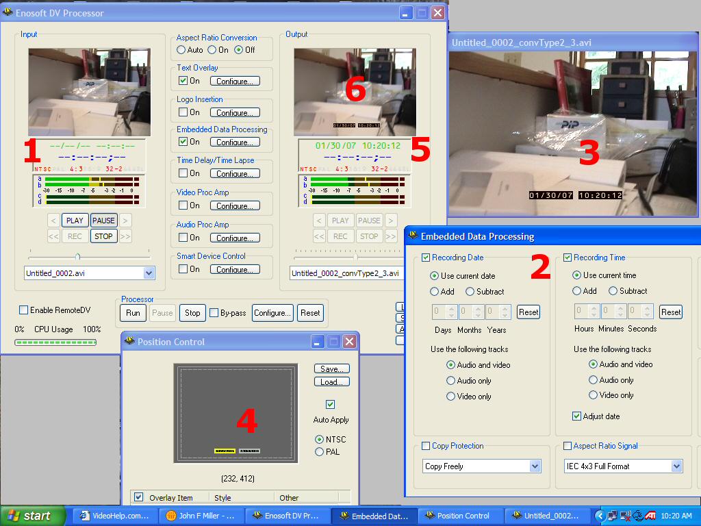

Here is a screen shot:
The numbered items:
1. The input DV. In this case, an AVI file, but it can be any DV device attached via FireWire
2. The options to use the current date and time
3. An optional 'preview' of the processed DV signal (actually decompressed from the DV) - this can be a full screen window/resized etc. Note the date and time burned into the video
4. The control to adjust the position and appearance of the date and time
5. The date/time info from the processed DV stream - you can see that the date and time have been added to the "meta data" - compare to the input which has no date or time info
6. Another 'preview' - similar to 3 but contained within the main window. Again, decompressed from the DV after the processing
In this case, the output is an AVI file, but it could be another DV device. So, if you have two DV devices, you can use one for input, one for output and process everything live without even having to capture to disk...
