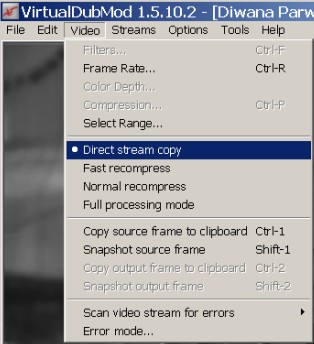

    Manono's post of 28th Jan '07 has worked very well for me as well. The trouble I'm having is that the file sizes seem to become very large once the synching process is complete eg. one file went from about 2 gig to 71,449,380KB. I don't want to go messing about with any other settings in Virtualdub without checking with the experts (you guys).
    A quick overview of programs I'm using: usually DVD Decrypter followed by AutoGK, or DVD shrink and then AutoGK. The audio being out of synch only happens on occasion and I haven't been able to determine whether it's either or both DVD Decrypter or DVD shrink causing the problems.

  19. Originally Posted by newbie72 View Post
    The trouble I'm having is that the file sizes seem to become very large once the synching process is complete.
    If using VDub(Mod) make sure and set Video to Direct Stream Copy.
    Apr 2010
    pacific
    Thanks for the reply Manono. Can you be a little more specific - where do I set Video to Direct Stream Copy? I think I'm in the right menu but want to be sure.
  21. Here:
