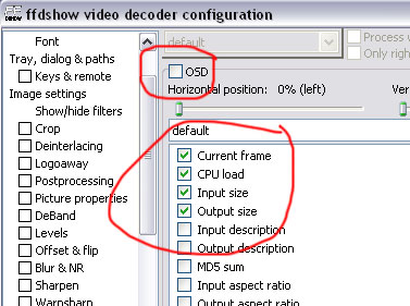

    I am converting an AVI file into NTSC dvd. All of a sudden, after Procoder started the second pass there appeared a sort of stamp in the video preview screen. it's green lines of text showing the speed of conversion and something else. They are upside down.
    I started the conversion anew but this time the stamp appeared from the very start. I rebooted PC, cleaned the registry but nothing helps.
    What could it be and how to fix it? Thank you.
    Jun 2006
    Canada
    Hi,
    Only today I noticed that all AVI files (pictures in thumbnails) on my HD are sitting upside down.
    All of them also have got a colomn of green color text in the left bottom corner:
    - current frame
    - CPU load
    - Input size
    - Ouptput size
    When converting in Procoder, those lines show the changing data and are visible at the left bottom corner of the Procoder preview screen and in the right top corner but upside down like a mirror picture.
    What's happened to my AVI files? How to fix the problem?
    Thank you!

    I have removed ffdshow and everything back to normal.
    has it got corrupted? It was installed quite a while ago and worked fine.
    I will try to install the latest version.
    Guys, thank you for your time!
    Jun 2006
    Canada
    I tried to install the latest version and all the problems started again.
    Can I live without ffdshow? If not, how to fix it? thanks.

    ffdshow is easy to setup and change. You simply set the codecs you want to libavcodec. The ones you don't to disabled. (on the decoder tab of course).
    And look what I found under MPEG-2......

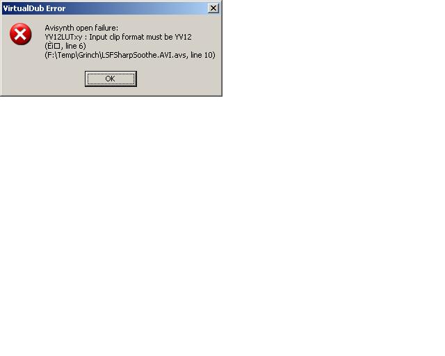

    After I uninstalled ffdshow and installed a separate Xvid codec, GSpot shows that the codec installed but I cannot open in VDM the AVISync script that worked perfectly well before all this. I get error message:
    The script:
    LoadPlugin("C:\Program Files\AviSynth 2.5\plugins\MaskTools.dll")
    LoadPlugin("C:\Program Files\AviSynth 2.5\plugins\MT_MaskTools.dll")
    LoadPlugin("C:\Program Files\AviSynth 2.5\plugins\RemoveGrain.dll")
    DirectShowSource("F:\Temp\Grinch\Grinch-1-No-Sound.avi")
    LanczosResize(704,480,0,1,1024,574)
    AddBorders(8,0,8,0)
    Dull=Last
    Sharp=LimitedSharpenFaster(Dull,ss_x=1.50,ss_y=1.5 0,Smode=4,strength=70,soft=30)
    Soothe(Sharp,Dull,25)

    Scorpion King,
    Thank you! It means I should uncheck the stuff and that's it, right? Wow, that easy!
    Dec 2003
    I can't say what these other guys might tell ya, but I don't enable any decoder I don't actually need. The problem I see with ffdshow is that when you install it all the items are selected and it is up to the user to uncheck what they don't actually need or want. I think ffdshow should install with nothing checked automatically, then enable what you need and only when you actually need it.
    It is always a good idea to actually know what is needed and what is not. I personally don't like using ffdshow for anything but what I must, and at this point, thats FLV and X264. Everything else I use and do I install and manage myself.
    You have some sorting out to do I think... Good luck.

  18. Member
    Jun 2006
    Canada
    Pinstripes23,
    Thank you! I will try it right now and will post the result.
    What is really confusing to me is that I used the sript yesterday and it worked perfectly weel till the moment when the problem descibed above came up.
    Jun 2006
    Canada
    Unfortunately it does not work.

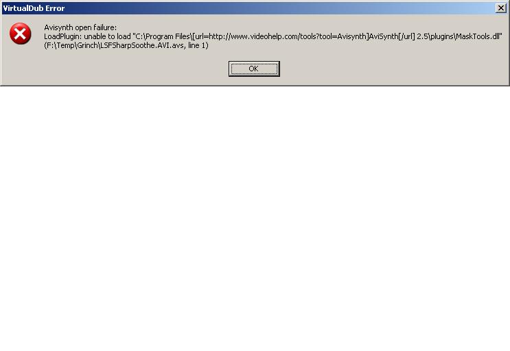

    If I use it as is, I get the following error:
    Jun 2006
    Canada

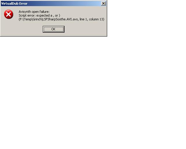

    If I change the first line back to:
    I get the error:
    Aug 2004
    can you post the script you're getting the error? I accidentally included the html link to avisynth in the script I posted. But the last error you mentioned is in the first line of your script(maybe you're missing a parenthesis). The script should read like this:
    LoadPlugin("C:\Program Files\Avisynth 2.5\plugins\MaskTools.dll")
    AddBorders(8,0,8,0)
    Dull=Last
    ConvertToYV12()
    Sharp=LimitedSharpenFaster(Dull,ss_x=1.50,ss_y=1.50,Smode=4,strength=70,soft=30)
  22. Member
    Jun 2006
    Canada
    You are right! I was missing parenthesis in front of ("C:\Program Files....
