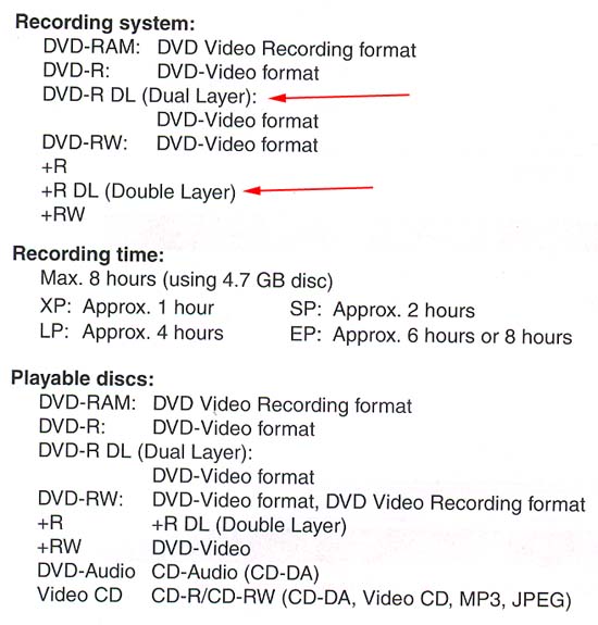

The Pansonic USA web site info is wrong. I am using a borrowed ES35V which is the same as the ES25 with a VCR but minus the HDMI interface. I use it to record double layer ( DVD+R DL ) with Verbatim media all the time and the manual says it can record dual layer ( DVD-R DL ) as well.
What is true is that it requires that the first layer be closed which can take a few minutes before you can record to the second layer which is not so great if you want to record a show continuously across the layer break but works well for compiling clips because the layer change can be set between clips instead of occurring within a clip. -

You are joking are you not? The ES35V does -DL and +DL and it has the option to autofinalize.

All three Panasonics, the ES15, ES25, and ES35V can do -DL and +DL. I took a Verbatim dvd+r DL into Circuit City tonight and tried all three. Each responded exactly the same. The display shows the word UNFORMAT as UNFOR and MAT alternating on the display.
