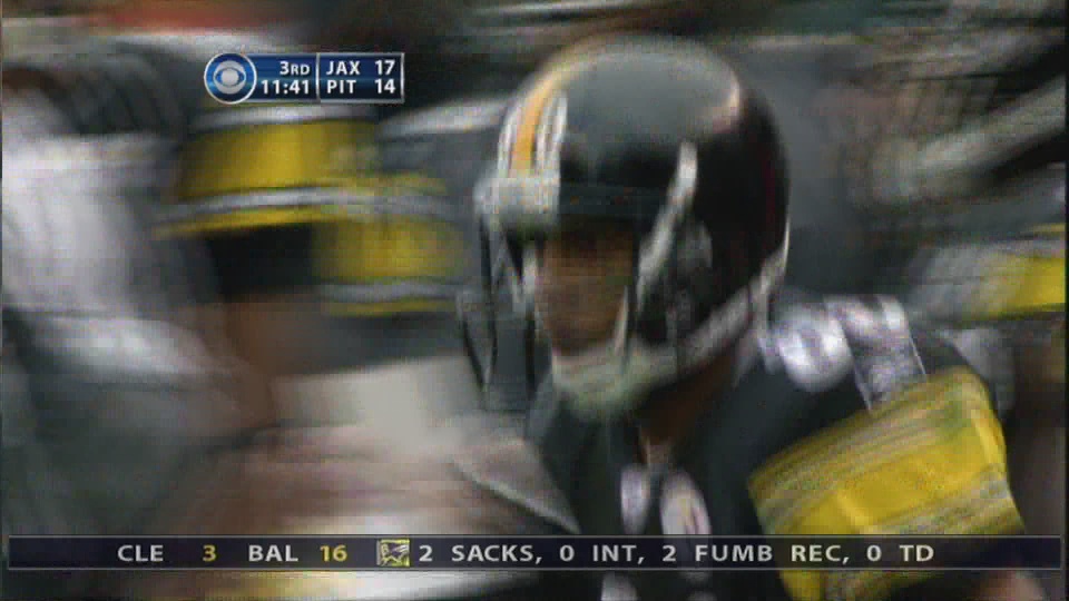

So no telecine. The S-Video output from a cable/sat* box will be 480i letterbox. Your progressive DVD player or HDTV will do the deinterlace in hardware. Use a deinterlacing player like PowerDVD on your computer. Keep the MPeg2 bottom field first interlace.
Software deinterlaced 1080i -> 480i looks yuk like this
