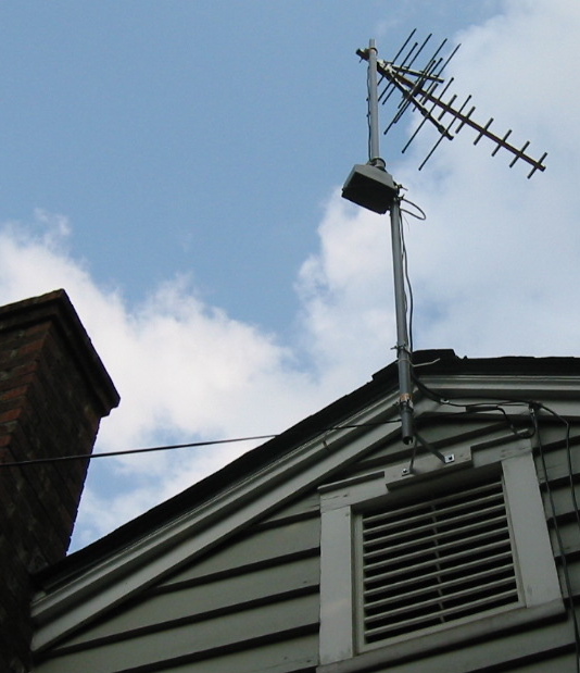

 Here is the 42" UHF Yagi I eventually installed. The rotator is for the PBS station, directly opposite from all the others, and about 35 miles away. Great reception BTW.
