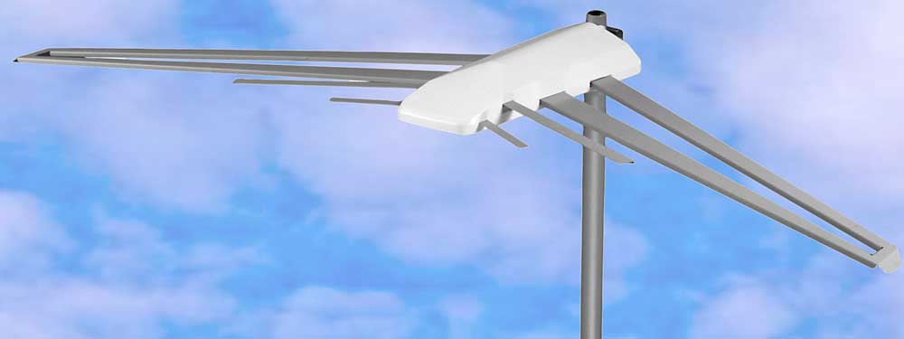

Okay, I found this one, http://www.antennasdirect.com/DB8_HD_Antenna.html, while I'm seaching through Google. Any thoughts on this?
By choosing that antenna you are telling us all the stations of interest are in the same direction, all are UHF and they are between 35 and 70 miles away.
If local and distant stations are on the same radial, you might find the locals overload the tuner. -
I thin I see what you're saying. The 4 locals that showed in antennaweb.org are within 30 miles or less. I just thought if I can get a better antenna, maybe I will be able to get the further channels from where I live. The 4 local channels are south of me and the furhter channels that I wish to get are west of me.
In any case, I was just wondering if that scenero can be true. It's more likely that will settle for those 4 local channels with an indoor antenna. I saw the one posted by MJA but not sure what the price is and if it is an indoor antenna or not. -
