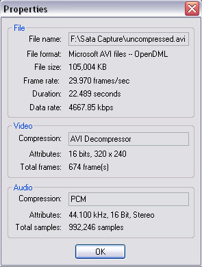

Just guessing but your files could be 16bit instead of 24. I just did a quick uncompressed VDM capture test and the files came out 16...?
Besides capturing in straight uncompressed also I tried ffdshow - uncompressed - and set it to rgb24. Worked great. Resulting files were 24bit.
You could use VirtualDubMOD and convert your files to rgb24 using Video - Color Depth - output format to 24bit.
