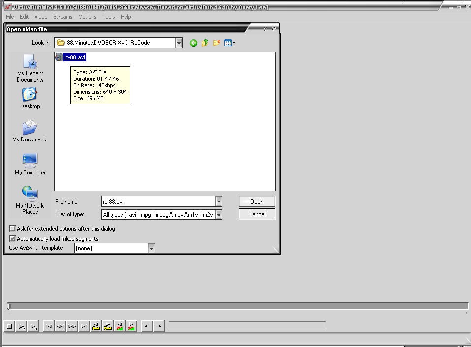

    Start V Dub.
    Select/File/Load Video File

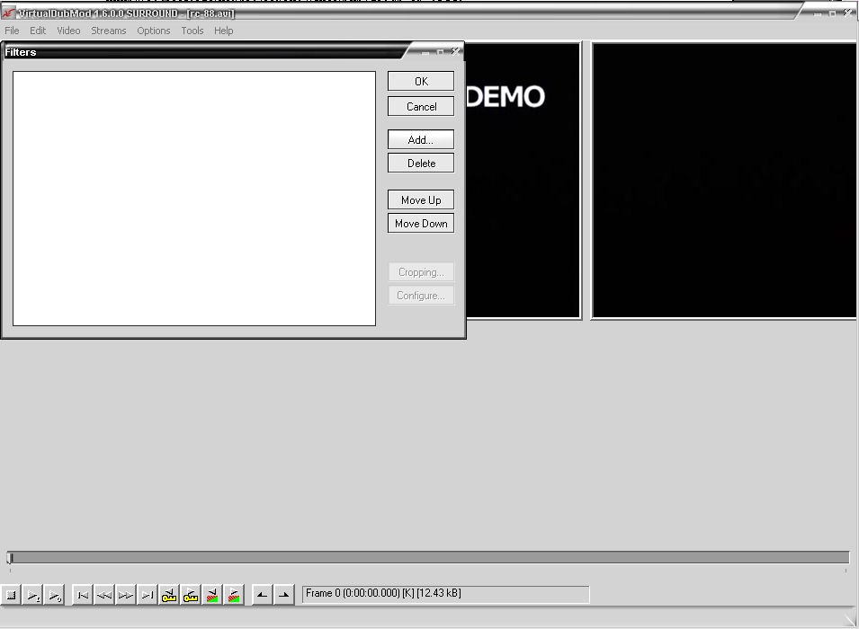

    Go to the Video Tab and in the dropdown select Filters.
    [Attachment 40579 - Click to enlarge]

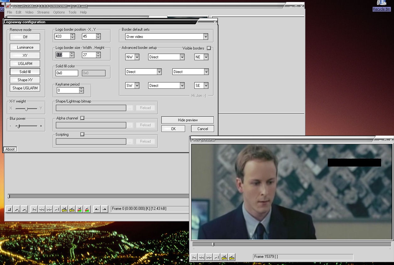

    Click add then select LogoAway
    Select show preview and slide the bottom bar to a frame with a light background, on the left select solid fill.
    [Attachment 40580 - Click to enlarge]

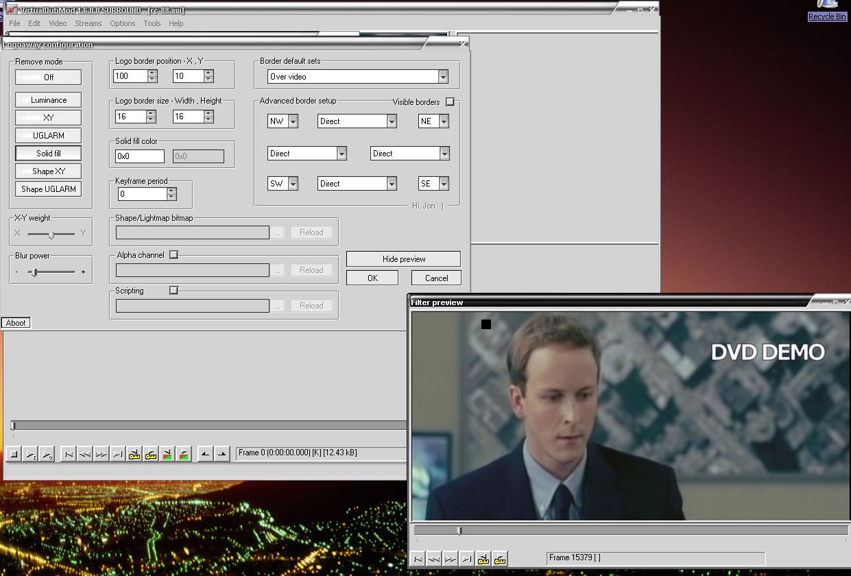

    Now using the X,Y position and size controls move the black box to cover the bit you want rid of.
    [Attachment 40581 - Click to enlarge]

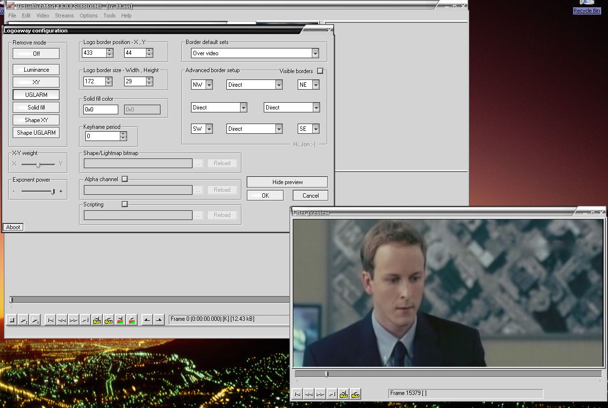

    Next on the left again select UGLARM and play about with the exponent power slider to mask the black box.
    [Attachment 40582 - Click to enlarge]
    Click OK & OK
