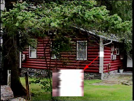

    I'll dig through my stuff and see if I can find a ratty signal for you, and post the image
    Edit: Here's one. Note the shifting of the horizontal lines in the high-contrast vertical edge:
