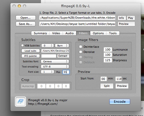

    I have another problem though,
    I've chosen everything, set my bitrate etc.. etc.. I've attached a JPEG of my settings on the filters tab of FFmpegx.
    When I encode the file the subtitles aren't hardcoded as I've expected them to be.
    I'm encoding a mpg(2) file by the way.

  9. Explorer Case's Avatar
    Feb 2004
    Middle Earth
    When encoding to DVD, the subtitles will be soft (selectable), unless "Decode with mplayer" is set in the Options tab. Only then will the subtitles be hardcoded (burned in to the video).
    The "Burn" drop-down selection in the Filters tab is there for what to do with subtitles in VOB source files, not for external subtitles.
    Nov 2011
    istanbul
    Ok. Question is I have two avi files of the same film. And I'm encoding directly to mpeg. Don't I need to encode to DVD (VOB) structure to get the subtitles to be soft and selectable. And if so, how would I be able to do that if I'm encoding twice for every two avi's or is the mpg file somehow wrapping the subtitle file as well? Is there a way to add multiple subtitles also ?
    Thanks.
    Kaya
    Nov 2011
    istanbul
    I set "Decode with mplayer" but the rendering seems to goes on forever without the progress bar moving. And the CPU is at 1 or 2 % so nothing seems to be moving..I redownloaded all the components and installed them again.

    Nov 2011
    istanbul
    Case thanks for the help man,
    Like you said joining the two files with hardcoded subs will work. Though i've managed to complete the render process normally (unlike before where it stalled like you pointed out) to hardcode the subs using the "decode with player" checkbox, I still got the video encoded without the subs.
    I wonder if any of the checkboxes, settings are somehow getting in the way of each other..
    Regards,
