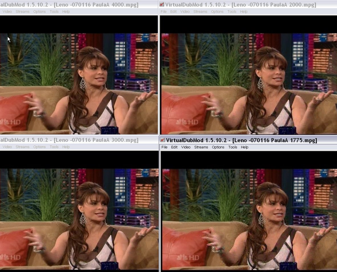

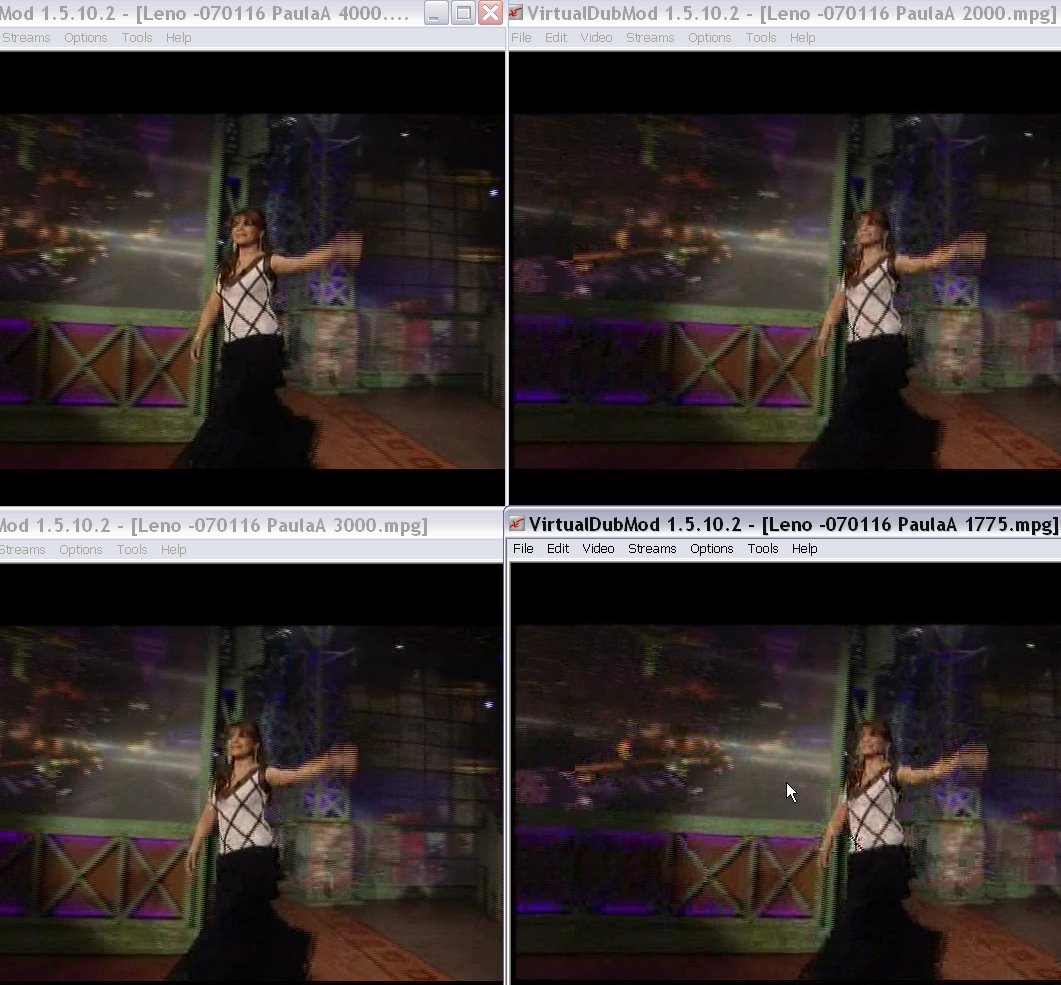

Encoder performance is heavily influenced by the camera source and the filming technique used.
For an "as broadcast" test I like to use the 720x480 SD output of a HD cable turner. I find a guest introduction on the Leno show offers a good simple encoder test. The sequence is usually:
Leno introduces the Guest and spins in his chair. A hand held HD camera captures the guest walking from behind the set with a single spotlight. This is the closest senario to hand held home rercording except they use a $30K camera and a bright spot. But the guest is waving and otherwise walking fast. The camera is zooming, panning and rotating. All in all a good test. Hard to show here. This was captured DV format and then encoded at various bitrates. On a CRT TV monitor, the interlace lines aren't shown so evaluation is easier. Bottom line, an expensive camera operated by a pro with adequate light can be compressed pretty tight in MPeg2.
In last night's show, Paula Abdul was a perfect walking test pattern for MPeg encoder evaluation. The criss cross black over white with white and dark textures plus broad dancer's gestures was pure gold. I'm going to try for an HD MPeg2_TS capture when this show is repeated.
For this quick test I used ULead VS9's Mainconcept encoder set to VBR 4000, 3000, 2000 and 1775 Kb/s.
When Paula reached the sofa, the very solid pedistal mounted HD cam was used with only occasional pan and zoom. Lighting is also perfect there. Those earrings make a good motion test. So experiment with low bitrates to force errors. Then add bitrate until acceptable.

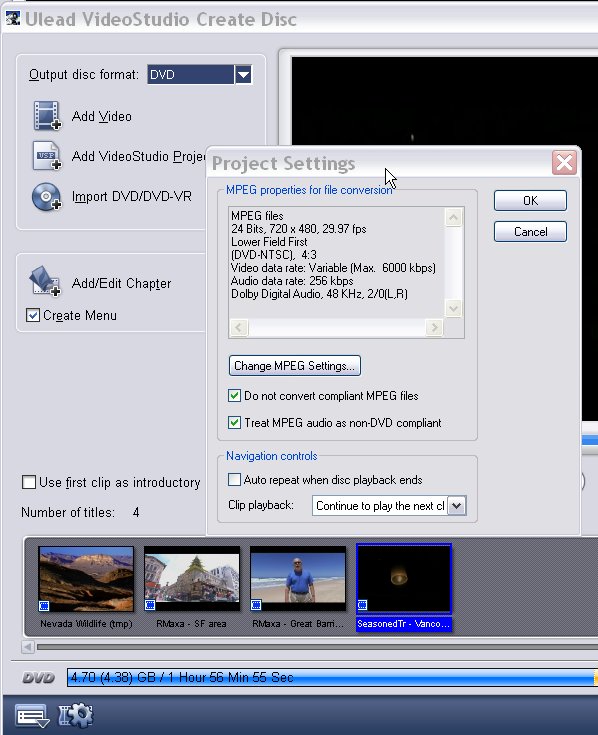

With Video Studio I can set a DVD MPeg2 project format (e.g. 6000Kb/s VBR) and real time encode a DV stream to DVD Ready MPeg2 (using project settings or a different preset). Or I can import existing DV or MPeg2 files and encode non-realtime.
When editing mixed DV and MPeg2 within a MPeg2 project setting, "smart rendering" seems to work for me so long as the MPeg2 matches project settings. I judge it is working when I get shorter render times.
Sometimes I use VS9 as a simple DVD Authoring program (starting with "Share" "Create Disc"). I "Add Video" (usually DVD compliant MPeg2 or MPeg1). All DVD compliant video seems to process without re-render much like in TMPEnc DVD Author. Offen the audio needs to be converted (e.g. 44KHz or PCM source to AC-3). Audio re-renders quickly.
The key settings are under the gear icon at the low end of the Create Disc Window.
Once you get the settings correct, I think you can get control of your re-rendering problems.
Well...I have set exactly the same setting, but with me it re-renders the files.Originally Posted by edDV
The difference with me, is that I add the files in the beginning. I add titles and transitions and then "Create Disc".
