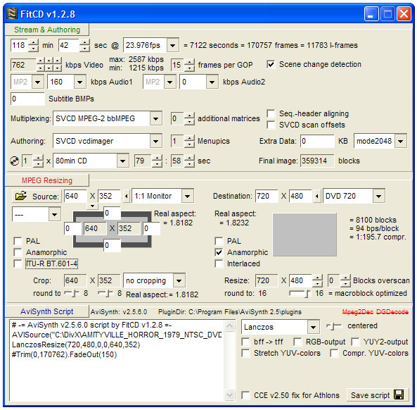

Since you now have a 16x9 WS TV then YES you will want to checkmark ANAMORPHIC on the right hand side.
Let me use an example.
I have a MPEG-4 (XviD) I made from the NTSC DVD of THE AMITYVILLE HORROR [1979]
If I load that AVI file into FitCD here is what you get:
See how easy that is?

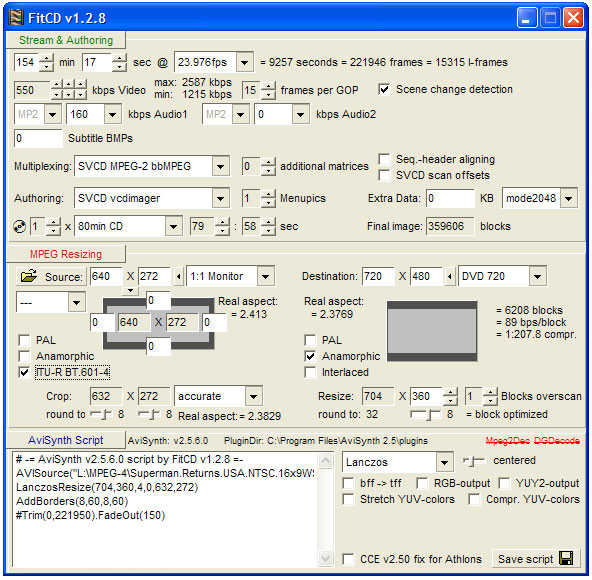

Now let's take a look at another movie. Here is a MPEG-4 (XviD) of SUPERMAN RETURNS which has an aspect ratio of about 2.35:1 (much wider than THE AMITYVILLE HORROR).
Does that make sense?

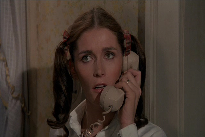

My AMITYVILLE HORROR sample is a MPEG-4 (XviD) clip I made from the NTSC 16x9 WS anamorphic DVD. The DVD had an aspect ratio of approximately 1.85:1Originally Posted by Adventure Man
When I converted it to MPEG-4 I got 640x352 and here is what it looks like:
Original MPEG-4 at 640x352
When you convert this back to a NTSC 16x9 WS anamorphic DVD you get the following:
720x480 NTSC 16x9 WS anamorphic DVD
This is how the image is stored on the DVD but when you play it back on a 16x9 WS TV then you will see this:
720x480 NTSC 16x9 WS anamorphic DVD on a 16x9 WS TV
If you watch the same DVD on a 4:3 TV then you will see this:
720x480 NTSC 16x9 WS anamorphic DVD on a 4:3 TV
As you can see the image will fill a 16x9 WS TV but on a 4:3 TV the DVD player will add black above and below the image to keep the aspect ratio correct.

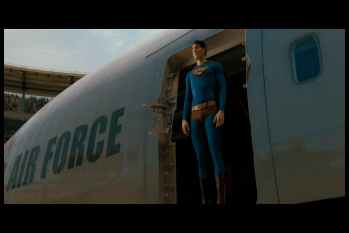

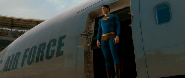

Now let us do the same thing with my SUPERMAN RETURNS example. Here we have a MPEG-4 made from the NTSC 16x9 WS anamorphic DVD. The DVD had an aspect ratio of approximately 2.35:1
When I converted it to MPEG-4 I got 640x272 and here is what it looks like:
Original MPEG-4 at 640x272

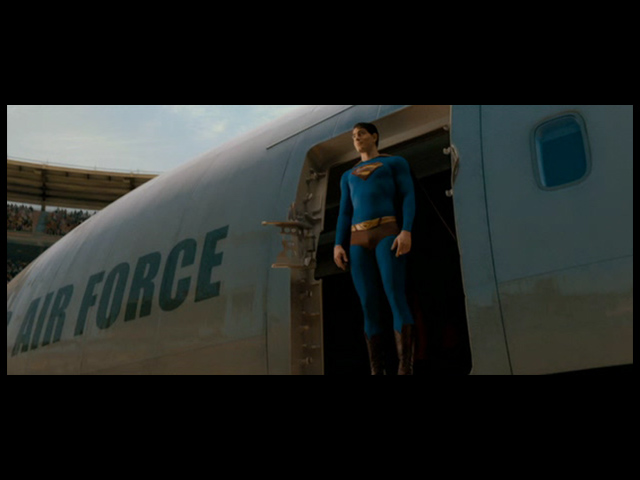

As you can see there is still black above and below the image even on a 16x9 WS TV since the film has an aspect ratio that is "wider" than the TV.
