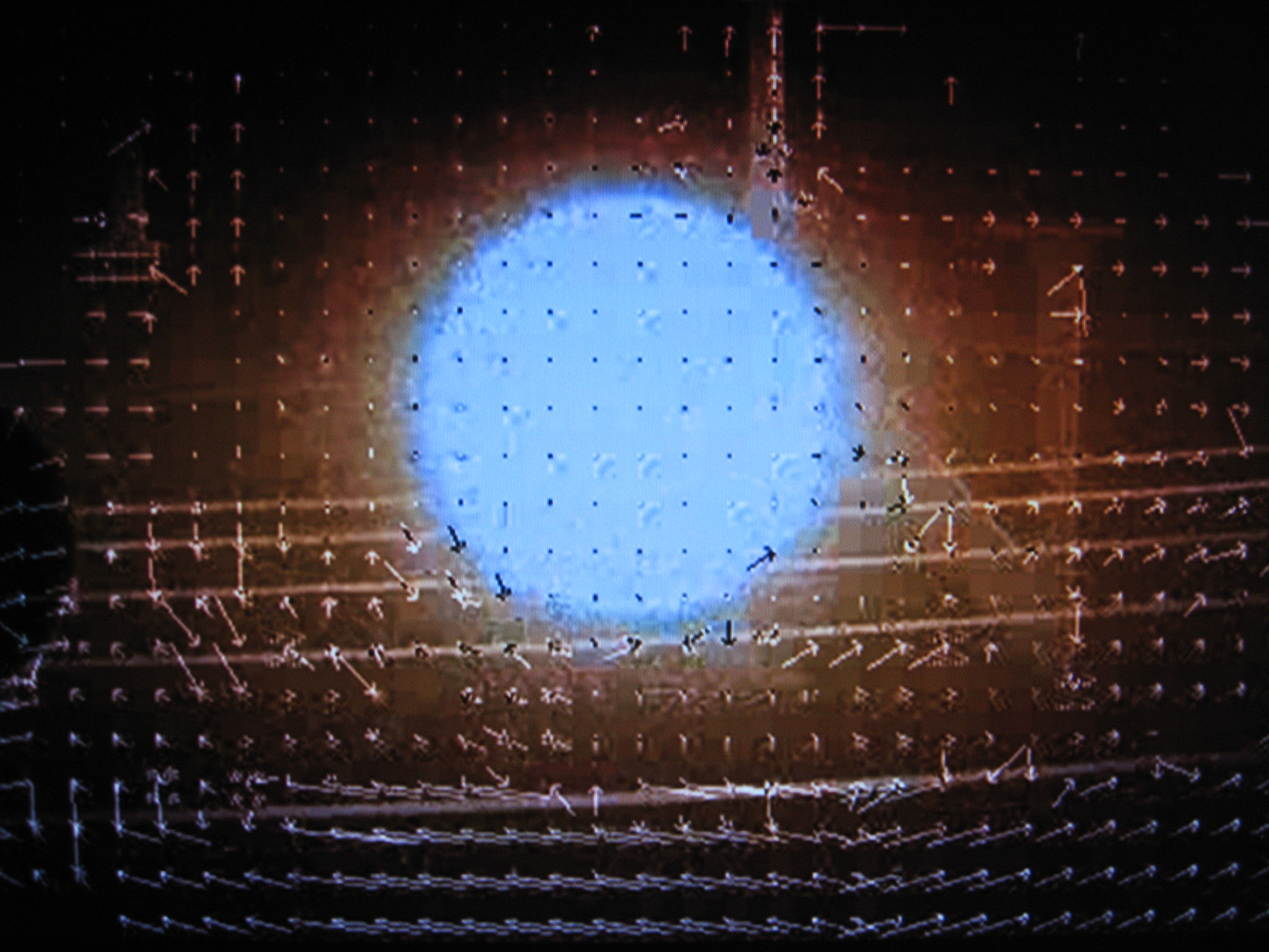

I converted one movie file to another format and I've got what you see on the picture.
Please help me to solve this problem and tell me what's going on.![]()
I cannot make printscreen because picture disappeared. I'll describe how it look. when i watch of this file I have on the screen thousands of small arrows in different directions.
After some problems I have a picture

You're using a filter that is displaying motion vectors. Turn off the "Show motion vectors" option.
Since you gave no details about what format you converted from, what format you converted too, what software you used for the conversion, and what software you used for the playback, it's not possible to say where the problem is. -
where I supposed to turn off "Show motion vectors" and how ?
Because I couldn't open mp4 file in virtualdub I convert mp4 to divx and I used Past River Video Converter for this. . I played my file in Zoomplayer and Clasic Media PlayerJKoniak -
EDIT: I have seen similar with the first pass with a VirtualDub antishake filter. It generates this information, then uses that to correct the video on the second pass.
Yes, I've see the VirtualDub filter called DeShaker do something like that. It looks different though. I've seen some MPEG analysis tools display motion vectors. I think there are some AVISynth filters that can show motion vectors.
If you open your final Divx file with VirtualDub do you see the vectors? -
On TV? You're using a DVD player that plays Divx files? Or are you using a TV connected to your computer?
Assuming the MP4 source file doesn't have the arrows, and they are part of the picture in the Divx file you made, the River Past software must have added the vectors during the conversion. Look through its options to see if you can turn off the motion vectors. -
I didn't know ffdshow had that feature. I just tried it and it looks very much like jarko's sample. If that's where it's coming from use:
Start -> ffdshow -> Video decoder configuration -> Visualizations (uncheck).
Start -> ffdshow -> VFW codec configuration -> Decoder tab -> Visualizations (uncheck).
