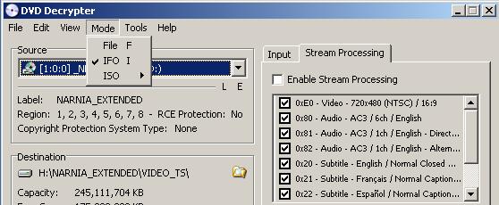

    3. Put the DVD in the DVD-ROM and open DVD Decrypter set for IFO Mode (at the top, Mode->IFO). In the Stream Processing Tab, for the video it'll say 16:9 or 4:3.
