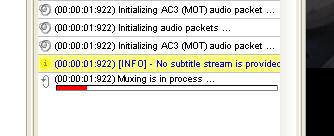

Dear George I don't get it.
I do everything by the book.
The thing is when I watch the process of the compile
I see the attached picture that no subtitle stream is provided
which is odd because I have provided 3 subtitle streams.
I added a button to activate subtitles from the menu.
Nothing happened.

Everything seems ok but when I compile it constanly says that No subtitle stream is provided..
Of course I double clicked the subtitle stream and imported the subtitle...
I think that I've tried everything -

Not wanting to be insulting, but just to get things straight.
You double-click on the subtitle stream
You click on the import button, and load your .srt file
You can, at this stage, see your subtitles (times and text) in the subtitle editor
You click on Generate Subtitle Stream to create the bitmaps
You click on close and return to your movie
You then compile the project
Is this the process you follow ?Read my blog here.
Then you have an issue with the subtitle file. Try opening it in Subtitle Workshop and saving a new version.
Read my blog here.
I know that you must be getting tired of my problem but I tried saving a new version with Subtitle Workshop.
Nothing.... -
Well my problem is solved concerning DVD Lab. Somebody from enother Forum suggested a newer version of DVD Lab, so I installed 2.23 and everything went well. I managed to load 2 subtitle streams and now I feel satisfied after 3 dayes of misery.
