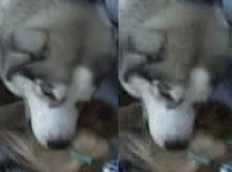

    Bu

  8. If you look at enlarged still frames from your SP recording you'll probably see that it's got some macroblocks. Using HQ instead would show less macroblocks.
    I listed several cases where SP would likely perform noticeably worse than HQ.

    Thank you jagabo for the pictures. I think by watching my copy (only one so far) on a 20-inch TV monitor, I could not tell the difference between SP and HQ recordings. If I had a plasma or something similar, the difference would be visible.
    Anyway, this is another case of misleading specification from the manufacturer. By labeling SP recording as "DVD quality", the manufacturer made me believe that my DVD will be as good as a factory-made DVD. Hm...I think the manufacturer should just give the resolution number for each recording mode and let the consumers decide which resolution appears most desirable to them.
    After all, what the heck is "DVD quality"? HQ, SP, EXP, blah blah blah, aren't these recordings done on the same media, namely DVD? Hence, shouldn't they all qualify to be called "DVD quality"? LOL

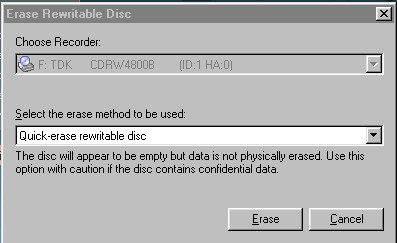

    I don't use re-writeable DVD discs. So, I don't know much about bout this type of disc for DVD. My understanding from re-writeable CD is that although the disc can be erased (data rendered unreadable), it does not mean the used space on the disc can be used again.
    For example, if I erase 250 MB already recorded on a 750-MB CD, I will still have only 500 MB of disc space that is recordable. The 250 MB of recorded data will still be there on the disc, unreadable, but you cannot record data over that. Please see picture below.

  21. Originally Posted by moviebuff2
    No, you have it backwards. It's DVD R that can only be written once as you describe. DVD RW can be writen, erase, and rewritten, hundreds, even thousands of times. In my experience I usually end up dropping and scratching the disk long before it wears out. With packet writing software you can treat a DVD RW like a big floppy disk.
    The quick erase option you refer to is like earsing the table of contents of a book. All the chapters are still there. With a RW disk you can overwrite the data (chapters) any time you want. Note that that option is available for hard drives and floppy disks too.

    Feb 2002
    Thanks, jagabo.
    I misunderstood that message from Nero, and I just stopped erasing the disc. Now the term "re-writable" makes sense to me.
