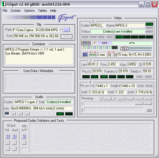

The Sony file is MPEG2 1440x1080i @25Mbps from the HC3. I think the only way to get the 'raw' file out of the camera is through the firewire (i-link) cable. That takes a program. I use Ulead VideoStudio v10 and it works great for that.

If it is being played from tape, then the file has been compressed to HDV 1440X1080i (4:3 aspect pixels) MPeg2 @25Mb/s. Playback out the HDMI port will be the decompressed version of the MPeg2 resampled in H to 1920x1080i. This would not improve the quality and could be considered lowered quality at much larger data size.
The HC3/HC1/A1U can also downscale the HDV playback to 720x480i in hardware to the IEEE-1394 port.
The real question is what happens when the live source is output over HDMI. It isn't clear that these camcorders have sufficient sensor resolution for true 1920x1080 (1CCD for R,G and B processed to 1920x1080i). HDMI can be RGB or YCbCr. If the HC3 outputs that latter then this Black Magic card can capture the 4:2:2 YCbCr HDMI
