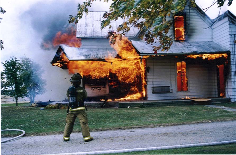

I am an electrical guy.Originally Posted by dimtim
I do not recommend putting a space heater on any timer that you can buy in a local department store! If you do that, your house may eventually look like this:
If I were to do this, I'd probably build something that could easily handle the load. I'll see if I can find something more suitable online. Exactly what wattage is this space heater? the Levotin thing is only a 10A device, not enough for most space heaters. In fact, anything big enough to do the job safely isn't going to fit into a standard size wall outlet box. -
