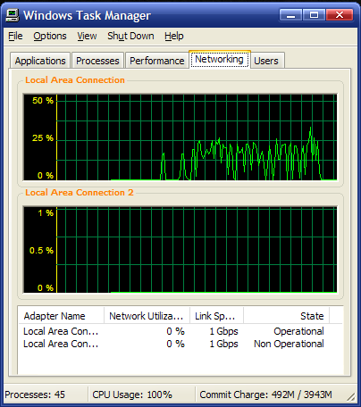

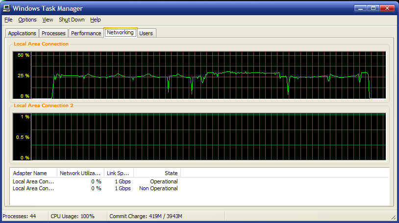

I'm also getting ~ 200-240Mb/s max but have noticed a fair amount of CPU activity on the slower machines even to the point of a 2.4GHz P4 hitting 100% CPU when transferring large files to/from a Core2Duo over a Gigabit link. This seems to limit throughput performance.
I haven't made detail measurements yet but I don't think the hard drives are maxing out yet. The PATA drives test out around 40-55MB/s (>320Mb/sec). The USB2 drives run around half that sustained rate.. -
don't forget we're talking ms windows networking..... there is a lot of overhead involved. a packet is sent, looked at, inspected, checksum matched, probably packet sniffed by the firewall/virus checked by antivirus, and then an ok to send another packet is sent back. it will never be as fast as hard drive to hard drive on the same computer.
