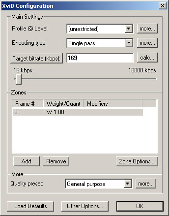

    My problem is that Im trying to change the resolution of this avi file with virtualdub but in order to do that, I need to use the "Full process" mode in order to enable the filter "resize", after resizing and saved my new avi to a new file, i want to recompress the avi with xvid.
    Under xvid video compression options it lets u select the "desired bitrate", i've set my desired video bitrate to 169 kbps but and audio to direct stream (original audio is 128kbps), but after compression my video becomes around 30 kbps only?? why isn't it 169kbps??

    What Encoding type are you using Single pass or 2-pass?
    Does it looks like this:

    yes i did exactly what u screened in that video, single pass, and the original file size is 1.2 gb with resolution 5xx (H) by 3xx (V) in 16:9 ratio, the original file size is 1.2gb because it was un-compressed. the runtime is 2 minutes and 5 seconds
    and i check the video kbps by right clicking the avi, then go to properties.
