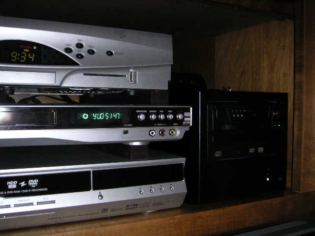

    You can also go external with both the HDD and the DVD burner. I am running two terabytes with the Polaroid now (eight 250GB drives). I set up an external drive enclosure to house both the Sony DVD burner and an IDE removable drive rack. It is black and to the right. Here's a pic:
    You'll also se the Toshiba RD-KX50 in the pic. In my opinion Toshiba is the best thing going right now. For many reason. Too many to list here.
