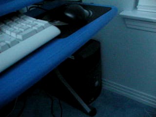

    Hello. I'm new to the forums and i would like some help.
    I'm doing a project for school and when i put videos into Windows Movie Maker, the video becomes blue.
    I've included a picture of how it looks like. Please I need help to solve this problem because the assignment is due on Monday!!
  2. Looks okay to me - the keyboard doesn't have a noticeable blue color.
    Most likely the camera's white balance setting is set incorrectly.
    What format is the original video? Is it DV or some other AVI format? If so, open the captured file in Media Player, find the same frame as the one you posted, press Ctrl-I to save the frame as a .BMP or .JPG and post it here. Without seeing the before and after, it's hard to tell if Movie Maker is doing something unexpected.

    ah ok ill post the original
    i dont think its my camera becuase when i play the original it's in color like this

  5. Originally Posted by stevelee2030
    Thanks. That helps!
    On a whim, I tried switching the red and blue channels using Paint Shop Pro. The result - pretty much what you are getting.
    So, for some reason the color information is being misinterpreted. i.e., RGB is being treated as BGR (or vice versa) or, for 32-bit pixels, ARGB is being misinterpreted as ABGR (A = alpha channel).
    EDIT - the other possibility is that, in YUV, the U and V are swapped.
    What is the source of the material? Most likely the wrong codec/colorspace converter is being used.
    Anyway, the solution would seem to be to swap the Red and Blue channels. Not sure of the best tool for that, especially given your deadline!
    Here's my reconstructed blue image (from your original brown one):

    Jan 2007
    1) Source- It's my digital camera Canon Powershot A620
    2)How did I create it? I just pressed the button and it recorded??
    3)Format?
    RIFF [ AVI LISTF hdrlavih8 j ?     ? @ LISTt strlstrh8 vidsmjpg j @B  ? ' @ strf( ( @   MJPG ? LIST\ strlstrh8 auds  + j9 + '  strf   + +   IDIT FRI JAN 05 12:28:51 2007
    LIST INFOISFT CanonMVI02 JUNK~
    P.S. The guy above mentioned Vegas. I found out my dad has Vegas on his computer. Is it possible to fix it with Vegas? If so please tell me.

    Jan 2007
    mm the problem is that when i view the original and view it in any media player, WMP, VLC, it has color and when i import it to Windows Movie Maker and save it as a DV AVI or WMV it turns out blue.
  12. MJPEG is quite an old compression format. Each video frame is simply a JPEG image.
    Since JPEG's are stored in a YUV format, it certainly lends support to the U and V planes being switched. (And, since the U and V relate to the black-and-white less red and black-and-white less blue, it explains why a simple switch of red and blue works).
    Microsoft provides an MJPEG codec with DirectX 9.0 and is probably the one being used.
    Can you post a very short AVI file (just one or two frames will do)?
    Re Vegas, TKS144 can probably assist there (which version does your Dad have?)

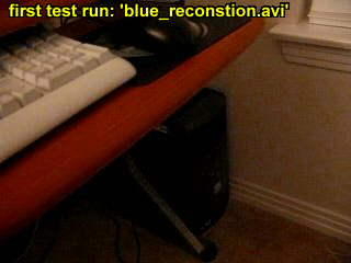

  14. Member vhelp's Avatar
    Mar 2001
    New York
    stevelee2030,
    It looks like your source could be a YUV source. I might be wrong. But you
    did say that you were using WMM, and I believe that it uses DirectShow to
    decode your source. And this leaves me to believe that it is decoding
    inside YUV color space, and is the probable reason/cause for the improper
    color planes.
    Below, is a AVIsynth script that will open a given .AVI source and swap
    the U/V planes (if encoding to YUV was V/U) back to normal. I ran a quick
    test using your pic (image) above, in this manor..
    ** I dragged it (opened it) inside virtualDubMod and saved it as an .AVI.. ie,
    ** blue_reconstruction.avi
    ** Then, I wrote a quick avisynth script (a text file) and included this file (below)
     # First test run of .jpg -> .bmp -> .avi -> avisynth[ swapUV() ]
     x = "d:\blue_reconstruction.avi"
     AVIsource(x)
       convertToyuy2()
     swapUV()
    Here is what it now look like.
    ** .jpg -> .bmp -> .avi -> avisynth[ swapUV() ]
    If you want to see if this script -cures- your U/V (blue) issue, copy
    and paste this script (below) into notepage and save it, and then open
    it inside virtualDub or virtualDubMod and see if the color is restored
    (or, decoded) to normal. The script is actually the same as the one
    above. (remember to use the proper PATH string. I'm using d:\ )
    and call it, 'blue.avs'
     # Second test run blue.avi -> avisynth[ swapUV() ]
     x = "d:\blue.avi"  ## your filename
     AVIsource(x)
     # convertToyuy2()  ## I desabled, for now
     # swapUV()         ## I desabled, for now
    Then, just drag this your editor or player and review it.
    If it doesn't change, just remove the '#' and re-save it and re-run it, again.
    [EDIT] -- it looks like your source is an MJPEG, and virtualDubMod is opening it, perfectly!
    No blue nonsense here.
    -vhelp 4191
  15. Thanks for the clip.
    On my Vista system, the file plays correctly (brown desk). When I drop it into Movie Maker and create a .WMV, it behaves.
    On a clean install of XP Pro SP2, the same thing - brown in, brown out.
    I suspect a rogue codec is somewhere on your system and it is being selected instead of the Microsoft one.

    Jan 2007
    ok i've uninstalled 2 codec packs i have installed and i will restart and check.
    Jan 2007
    wow thanks guy my problem is solved!!!
    the problem was simply the rogue codecs!!!1
    thanks anyway guys especially johnny who helped me from the start.
