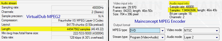

    Could this be the problem? Both programs are loaded with the original AVI file, Mainconcept Encoder shows a lot more of audio samples than Virtualdub do, could that be the problem that leads to the unsynced A/V ?
  13. Always Watching guns1inger's Avatar
    Apr 2004
    Miskatonic U
    Use ffmpeggui to convert the mp3 file to AC3 and test again. If this still works (i.e. keeps sync) then the problem is with how mainconcept is encoding the audio.

    I've rip the mp3 track from the original AVI file and convert it to AC3 using DVDLabs and it worked like a charm.
